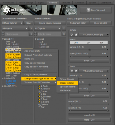

I can't find the type sub-menu.. sorry i spent 10 min clicking on everything.. can you post a screen shot if you have a minute.

here you go: btw, changing materials to the "mix" type creates a diffuse/glossy mix material using the same set of texture maps.alaman64 wrote:I can't find the type sub-menu.. sorry i spent 10 min clicking on everything.. can you post a screen shot if you have a minute.

Thanks for the screenshot, will try it when I get home this evening.
