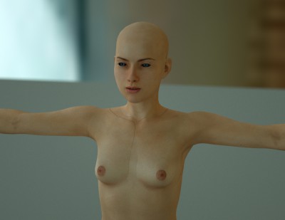

Just doing a test render with the new "Roxie" figure in Poser Pro 2014, using the Octane Render Poser plugin (v. 1.16a5). Just the default, zeroed character with the default materials.
As you can see, there are some problems. The eyes render black, for one. I searched the forum and found the thread about eye meshes sharing the same vertices. The only material assignments for Roxie are CorneaLeft and CorneaRight, EyeballLeft and EyeballRight, and IrisLeft and IrisRight.
I have tried setting the opacity of the Corneas to 0, and also setting both the Corneas and Eyeballs to 0. It doesn't do anything--still black. If I set the Irises to zero, then obviously the whole eye goes black. Help?
The second problem, as you can see, is seams in the figure mesh between polygroups. Any ideas?

Now I just need to figure out why the mesh is broken. It almost looks like it is subdividing/smoothing each polygroup separately, but I'm not sure what to do about it.

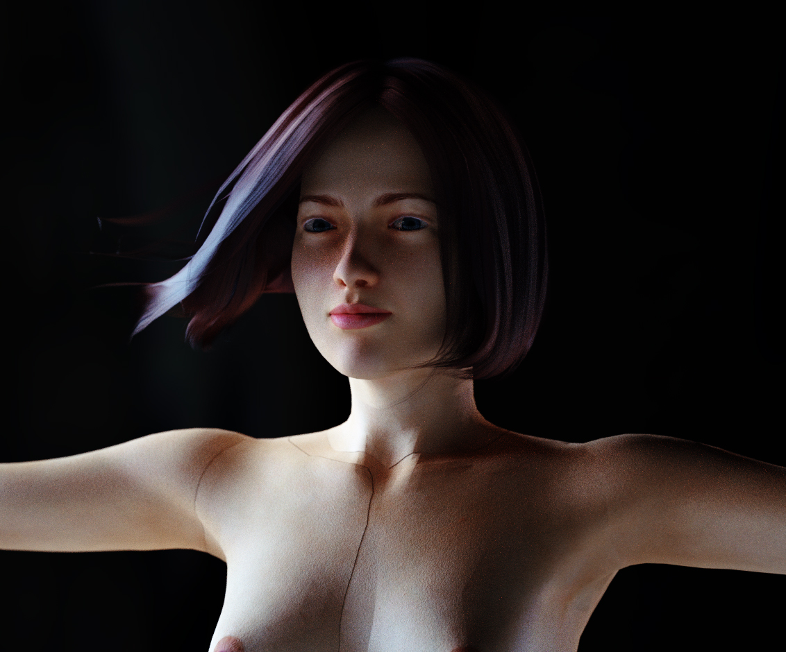

mind you i using poser 2014 and geting the same problem on same model
I haven't been able to reproduce this yet. Try moving the Poser animation slider to the next frame and then back - does that fix it?
Nope, unfortunately not. I've also tried restarting Poser and reloading the scene, and also restarting and making a new scene, but the problem persists. (At least the eyes are looking better!)

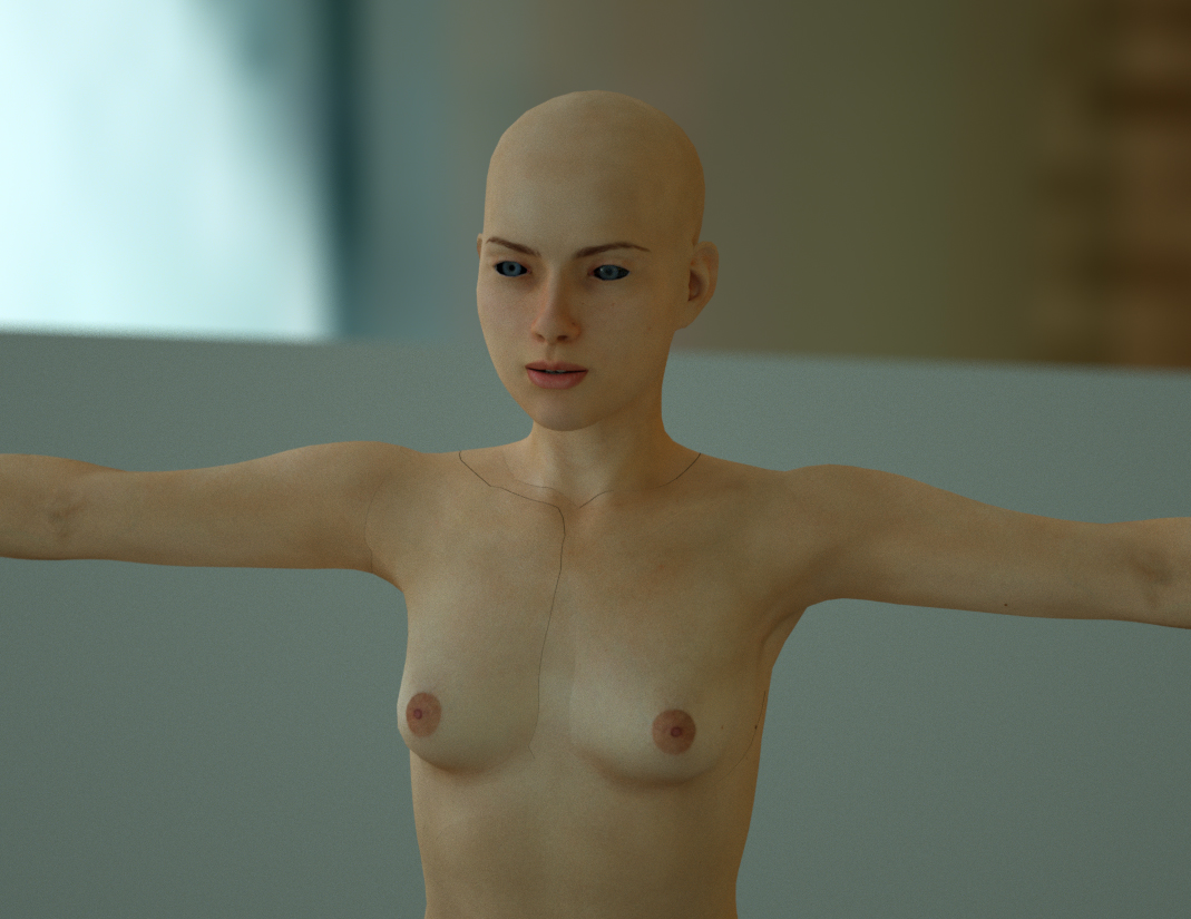

Ah, I see what you are referring to now. PoserPython has not yet been updated to handle the subd meshes with PoserPro2014 yet. I will keep talking to Smith Micro to push for a fix to this ASAP.

Also, to render Roxie at the moment (prior to a Smith Micro subd fix), you can simply select Roxie -> Figure -> Skinning Method -> Poser Traditional. That will remove the seems.

face_off wrote:Also, to render Roxie at the moment (prior to a Smith Micro subd fix), you can simply select Roxie -> Figure -> Skinning Method -> Poser Traditional. That will remove the seems.
Right you are--thanks, Paul. Hopefully Smith Micro will get a fix out for the subdivision issue soon, but getting rid of the seams is a big improvement.
