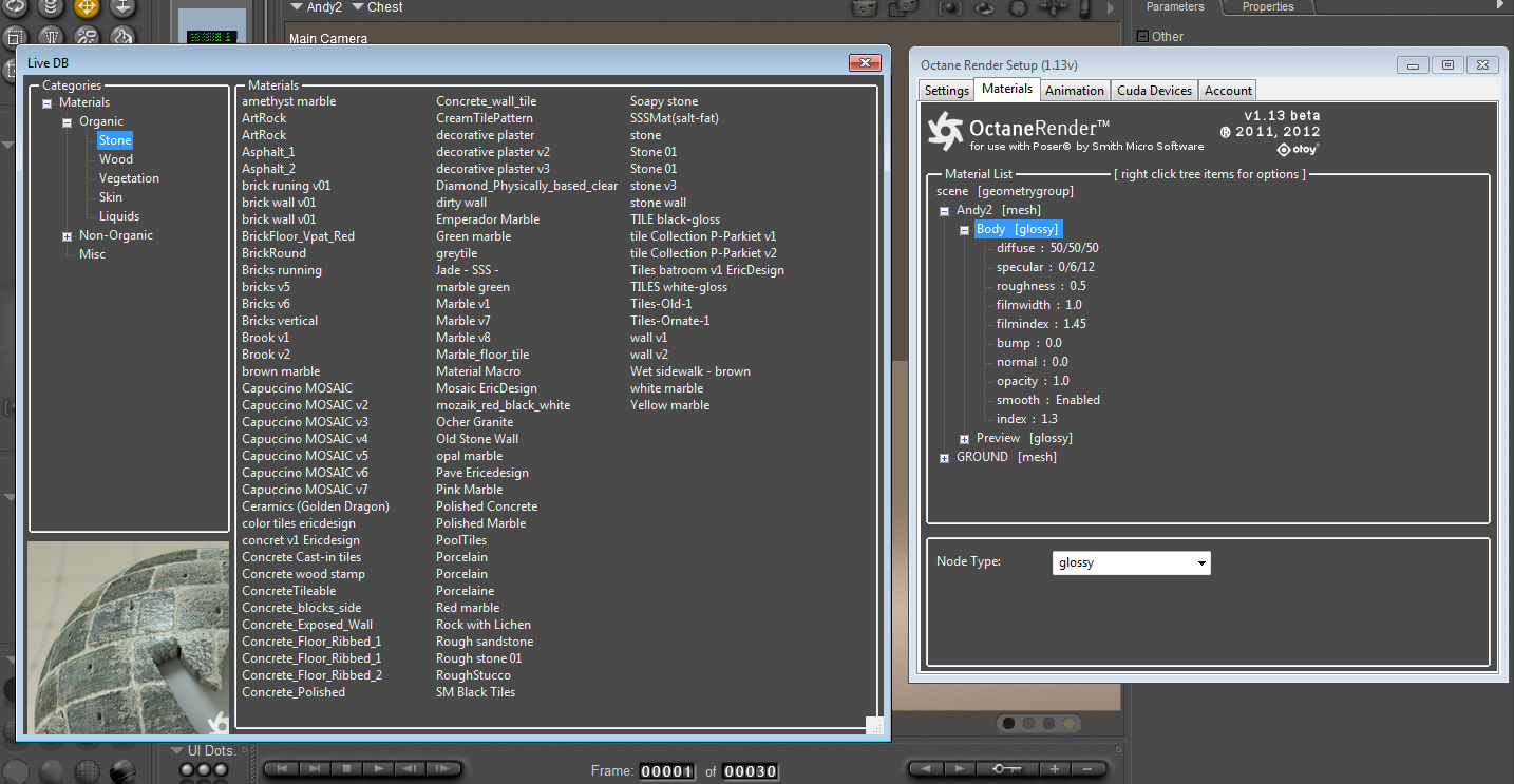

Thought I would start posting some details on the "re-vamped" (1.13v) Poser plugin - hopefully ready in a few days.....
The biggest change is that it doesn't load the scene into Octane when the plugin starts. Instead, the Octane load happens when you open the viewport. That means you don't need to wait for the scene load prior to editing materials, etc.
There are a heap of minor "tree" editing changes, but the biggest one is that the Settings and Materials trees are not generated from the Octane scene. Instead, they are generated from the Poser scene, and then the Octane nodes are created from the "tree"s. That means small things like the Transmission pin will no longer have an "floattexture" node attached - it will be "unplugged" instead and you can assign a node to that pin if needed. This will also happen with the "emission" pin.
The above changes should be pretty much invisible to - however in the event that something goes wrong (graphics card failure, etc), then the plugin will handle that in a much more robust fashion.
Other changes include a migration away from the OctaneDefaults.py file. Instead, the majority of settings will be in an xml file, which is maintained by the plugin. There is a new Configuration window to edit these settings. Also, things like Setup and Viewport positions and sizes are retained between sessions via this file.
Moving away from the OctaneDefaults.py file also means I can build an installer for the plugin, which will improve the reliability of my builds, and lower the potential for people to install in the wrong place.
Other changes include: Resolution Lock button now on the Setup window, so you don't need to open the Viewport to change the resolution lock, you can now load/save entire rendertarget settings (and set a rendertarget as the "default" for all new scenes). Setup and LiveDb windows can now be resized and remember their size between sessions (see image below).
A test version will hopefully be available in a few days.
Paul

face_off wrote:Other changes include: Resolution Lock button now on the Setup window, so you don't need to open the Viewport to change the resolution lock, you can now load/save entire rendertarget settings (and set a rendertarget as the "default" for all new scenes). Setup and LiveDb windows can now be resized and remember their size between sessions (see image below).
That's nice, too!
Do you think, there's a chance to implement a resizing of the image in the viewport, so that when you render in a high resolution, you still can zoom out to the whole picture (like the standalone does)? I tend to render bigger than my screen resolution... :D
What do the numbers behind the nodes mean (e.g.: diffuse:50/50/50)? RGB values? Wouldn't it be cool to display the actual color, too?
