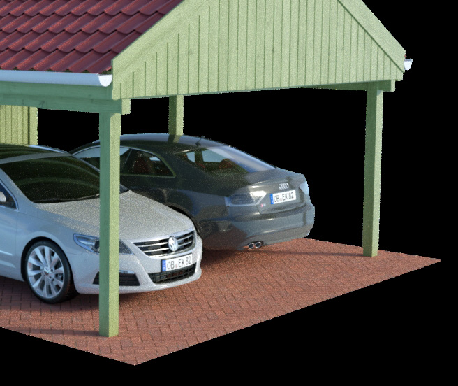

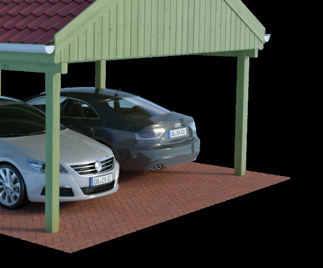

I'm fiddling around with HDRI maps (neverending story for me) and like usually I try different tricks to get rid of fireflies.
Now I figured out that if I use Pathtracing and click on "Alphashadow" I get a clean image. If I uncheck it they are very obvoiously.
If this a feature or not intended?
Attached two shots with and without at 1700 samples. Even at 5000 it didn't clean up before.
Using caustic blur = 1
HDRI gamma = 1,5 (makes lot of difference, but I loose sharp shadows although image is blurred a lot)
Power =0.7
IMportance sampling = on
No hotpix removal.

I just noticed. If I press the little update button it seems to be broken.
If I close the interactive window and reopen again the image clears after almost 500 samples. It is reproduceable.
Interesting is, if I check off the import-sampling the image renders darker.
