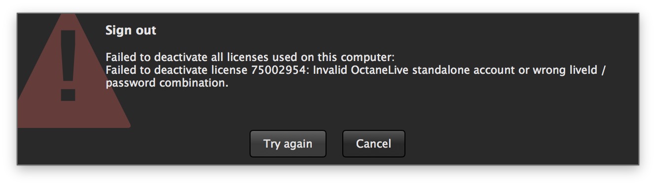

joecurrie
Posts: 28
Joined: Wed Aug 05, 2015 8:00 pm
Just tried signing out manually in the C4D Octane settings panel and got this?
Mac OS X 10.11.4 - Cinema 4D R17 | Geforce GTX980 + 980ti | 32GB
mojave
Posts: 1434
Joined: Sun Feb 08, 2015 10:35 pm
joecurrie wrote:How exactly does offline licensing work? do you have to be online to enable offline licensing? Seems a bit odd to me
It might seem a bit counter-intuitive but it's not ;) Octane's licensing system uses a floating license scheme, which means that it is the server the one that accounts for the usage of licenses and dispatches available ones to your computer. For you to obtain a license you need to go online at least at the time of getting your license from the server for the first time (which happens when you sign in). With offline mode you can then make your machine completely offline and the license can still be used as it's locked to it.
joecurrie wrote:Just tried signing out manually in the C4D Octane settings panel and got this?
I will send you a PM to investigate this further.
