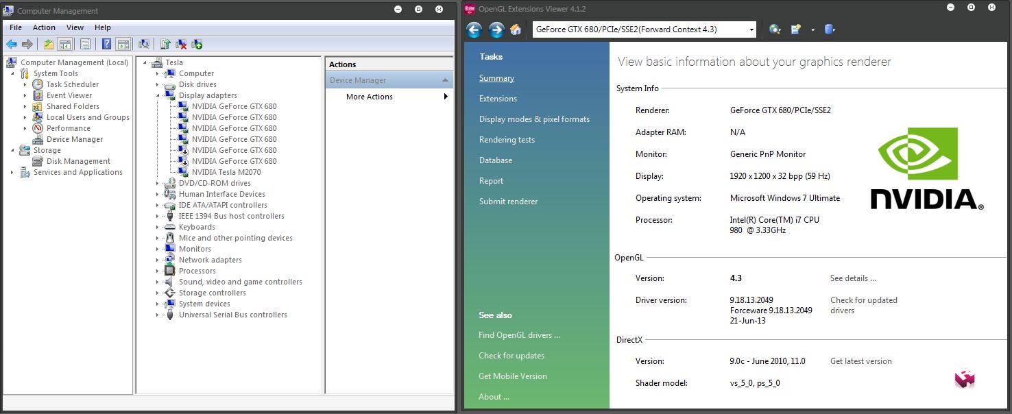

hey Boris. same here with my setup (consider the two disabled 680's in device manager): Only disabling of 2 gtx will help.BorisGoreta wrote:And this is what I get if I disable two cards. You can see in device manager that 2 cards are disabled. Now I get proper OpenGL version 4.3.
my experience with all 7 CARDS enabled
- octane for max WORKS without problems
- octane standalone crahes
- PHOTOSHOP cs6 degrades and does not use GPU accelleration
- PREMIERE crashes after hitting play
- AFTER EFFECTS crashes after hitting play
i somehow like the degrading behavior of photoshop because then i am sure the program does not interfere with the rendering process.
are there similar observations with your system?

oh missed that. buahh. just made a fresh install because of an ssd failure. but win7.BorisGoreta wrote:Juct checking in to report that there are no OpenGL issues with 6 TITANS on Windows 8, no need to have any of them in SLI.
this news are somehow good and somehow bad news for me I guess
what about the program behaviors I spoke? have you experienced them in win7 and in win8 not anymore?
edit: hmm I guess I will give it a try when this start button is definitively back (8.1). hope till then the octane standalone export will be reality, too.

in win8 all apps work great amd have full opengl support with all gpus enabled. really, save yourself a trouble and move to win8. if you use wacom tablet a lot wait for win 8.1 which will be released soon
tnx for the reply.BorisGoreta wrote:in win8 all apps work great and have full opengl support with all gpus enabled. really, save yourself a trouble and move to win8. if you use wacom tablet a lot wait for win 8.1 which will be released soon
that sounds promising.
