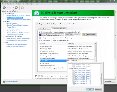

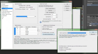

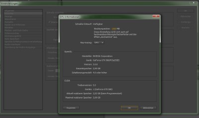

Hi BorisGoreta,BorisGoreta wrote:How do I set a program to use specific GPU ? I use Lightwave. Photoshop also doesn't work with GPU acceleration so I would need to set this for it too.
I see options to set GPU affinity for CUDA but not for OpenGL
I have a non SLI Setup, non of my GTX cards are connected by SLI.
I set the GPU activation with the NVIDIA system control panel, and yes, it is mentioned as CUDA, but seems to affect Open GL, too.
Here for example for Photoshop: And here the settings in Photoshop (seems to use OpenCL, not OpenGL?): And here the gpu information of the preview tab in after effects, after only activating one GPU in the nvidia control panel. If I don`t deactivate the other gpus for AE, I have issues while using them in octane or even if they are not in use. Seems like AE cannot handle more then 3 or 4 gpus. All these pictures were made while my other 7 GPUs are rendering an animation in C4Doctane at full load. So one GPU left for the other programs and somehow C4D handles to use the one left GPU (the GTX in my PC) for OpenGL preview, too. So I can still smoothly browse and work on another scene in C4D while rendering.
I`ll check my Open GL versions later with the utility you mentioned.
Maybe Lightwave handles the GPUs somehow different? Did you try to determine the CUDA gpus with the nvidia control panel for the lightwave.exe?
