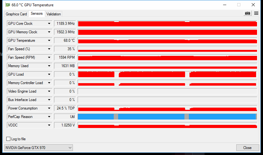

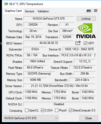

Hey calus,
Thanks for helping me out with this. I took your advice and downloaded what you suggested. I've attached the results. It doesn't seem to be overheating, as far as I can tell.

Oh sorry I missed that, so it does not seem to be GPU failing after all.RyDarling wrote: - This scene rendered out with no issues last week with higher settings.
