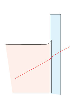

Seem we just don't understand each other
here is a scene with render and reference
I can also bring great examples with errors made ​​by the error render.
Suffice equivocate. Can see that this is an obvious stud! Pictures is hiding the truth.
And if you do not see this so much the worse for you.
Tell me will fix a bug or not?
Tell me that you will not do it and I will not write.

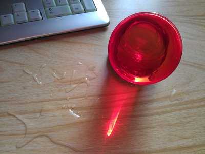

Karba wrote:Seem we just don't understand each other
Is red glass with clear water should look like that? I guess not.

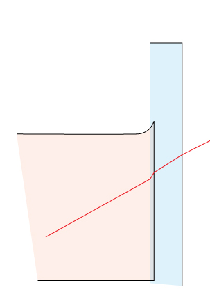

Hi karba
I just think everybody here wants to use the vray way : much more easy to model, animate and tweak.
That way every material has its own ior. The engine have to remenber which surfaces have been intersected along a ray path.
Building every intersection and calculating the ior between materials has no sens. :roll:

Hi karba
NO Biket! No! Oh my God! NOOOO!
Because Vray-way is Biased, wrong, unnecessary intersection, more poligons needed, it is need to more recalculate the engine!
Octane engine In the base is correct, the problem only in interpretation of surface that ray cross! ONLY in that.
It is need to go Maxwell way - Unbiased!!!
I'm so crazy because it is my business!
