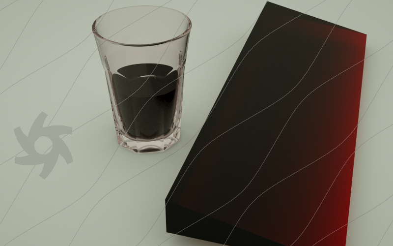

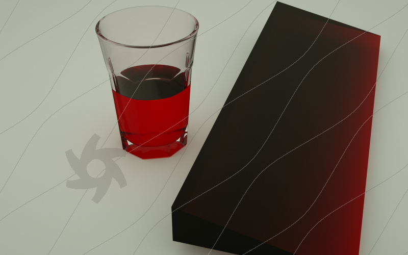

truerender, what I don't see clear in the image is if 1+2 is the slight overlap method or there's a small gap between container and liquid. It looks like the latter.
Doing some tests I noticed something: the attached image shows the overlap method where the liquid has absorption (the slanted rectangle has the same material). Notice how in the overlap areas the material loses all it's absorption properties!! whereas from above it looks correct...
The second image shows the 'liquid enclosed with a slight gap' method. The material looks alright, but refractions are not ok.
I insist on the overlap method over the maxwell method because of animation.

In method 1 +2 have the intersection (overlap). So we are making the stick liquid the glass.this Maxwell method doesn't work at all for animations!
Other if we have a small gap that will be all right - but it's just two items are inserted into each other, but not the liquid adhered to the glass!
Animation is about the second question. I honestly do not care as long as it.
In your test, you can see for yourself.
Once you have very dark liquid.
