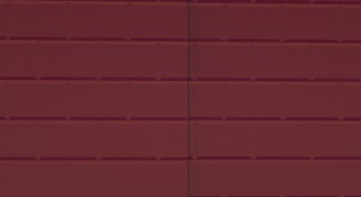

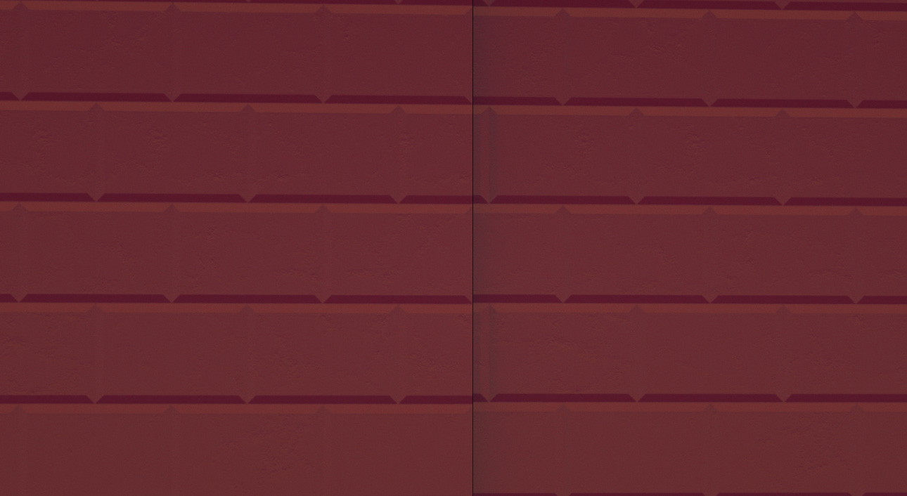

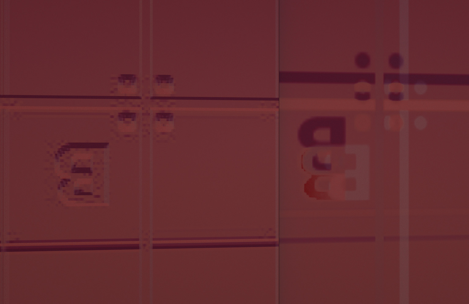

I did a bit more testing. Trying to get it to work via OSL shaders. But with them it's the same result.
But here is another thing that I found out. I did an even more extreme test. I put an object 100x the size next to the normal sized one and reduced the UV by 100 to match the map size. As you can see, in the downscaled version it looks as if the color channels are drifting apart. And that might lead to the blurry and harsher look of the bitmap. To make it better visible, I reduced the Power value of the downscaled version to 0.01 - otherwise the bump map would be too dramatic. Maybe this helps with getting closer to the solution of the problem.
I also tried it with Normal maps and there everything is fine.

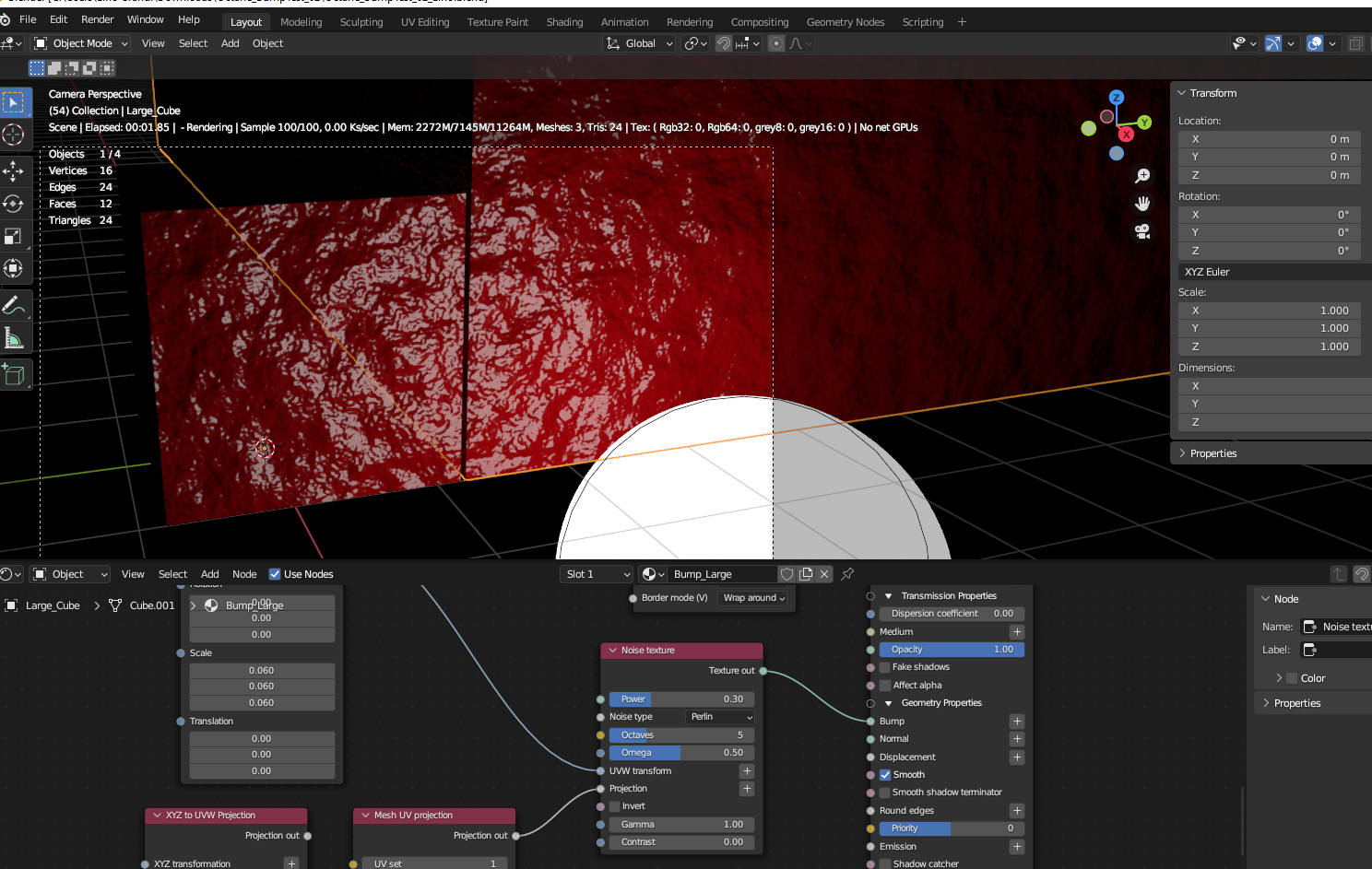

That's what I came up with in realtion to the bump mapping issue.
I've modified your scene a little bit.
On the small box, the bump intensity is set to 3.
Consequently, since the other box is 10 times bigger, to get the exact same amount of bump I've set the bump intensity to 0.3 (3/10).
This makes the bump effect for the two material totally consistent: Of course that may be an issue as we have very different sized objects and we need to use UVs to map them.
Bump intensity shouldn't depend on the object size. Let's see what can be done to solve this.

I've already tried a variety of approaches by modifying strength, gamma, contrast etc. It looks like it could work, but it really doesn't. As you can see in my previous posts it's not just about strength but also about sharpness. If you try the same with a factor of 100x, the situation gets a bit clearer. I fear this will have to be solved on the engine level.

By the way, while I think the intensity bump is something that should be solved (Cycles does it well), different sized object sharing the same material setting will still be an issue.
It's a question of workflow. The real problem here is not the object size, but the relative UV size of the meshes. If we fix the distance, we're fixing one of two correlated workflow issues.
And the other one (finding the correct "transform" size for different sized mehses) will still need to be solved "manually" by the user.
That's why other projection methods (Triplanar above all!) are highly recommended in these kind of situations, unless UV's for all the meshes in the scene are "proportioned".
I've made a scene showing the 2 boxes sharing the exact same material, and the same bump effect. You can change size and intensity as much as you need, and still get a perfectly consistent result, thanks to the correct relative size of the UVs, which solves both issues at once.

I tested your scene. There seems to be a bit of a misunderstanding. I'm not using the same material for the small and the large object. I just use the same bump map image. Their materials have different scales in the UV transformations. In fact, they could even have the same UV maps, just the transformations for the bump map are different. In your file the small and the large object share the same material, yet have different UV maps.

I know you're using different materials. I've made the scene just to show that there's a way to solve the issue when applying the bump to different sized objects. Of course that implies joining the meshes into one, then recreate the UVs and eventually divide the parts again into separated objects, if needed.
That's the only way to solve both the transform and bump intensity issue in one go, using just one material.
I really hope we can solve the intensity bump issue when UV projection is used, as you asked.
