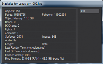

Octane says he counted 5563 objects - I don't know how he counts them. There are several dozen trees - in fact, the range of the number of polygons is from 40,000 to 1,200,000. Plus flowers, plants, etc. This is not a forest - this is part of the city.

Ok, and how much Out Of CORE RAM is using when you start rendering? Because from what i've read it seems that OOC usage limits/disablees RTX speedup/function.
