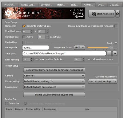

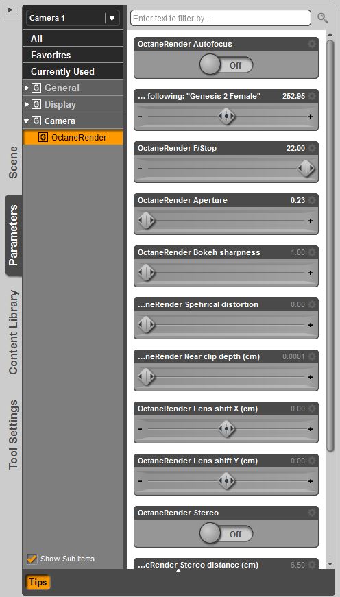

It seems like the lowest setting that 1.2 is allowing is 0.23??? Anyway, you should see something like the attached image for your camera settings, be sure to use the Octane Camera settings. If you still can't change the settings, it may be an issue with the fact that is an animation. Maybe using the "Get Current Camera Settings and Environment" button in the Octane Render Pane (second attached image).

If you follow what I wrote in the previous post (disable limits in "OctaneRender F/Stop") you will be able to change the "OctaneRender Aperture" to 0 (the F/Stop then changes automatically to "inf"). As far as I know this is the only way to get rid of the DoF completely (it behaves the same way as if you were rendering using DAZ perspective view without setting up a camera). The tips that livanchene gave are useful, but whatever the setting, you'll still get some, even minimal, blurring in the background.dustrider wrote:It seems like the lowest setting that 1.2 is allowing is 0.23???
