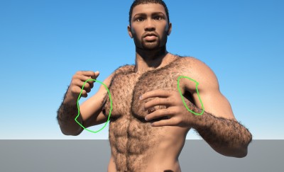

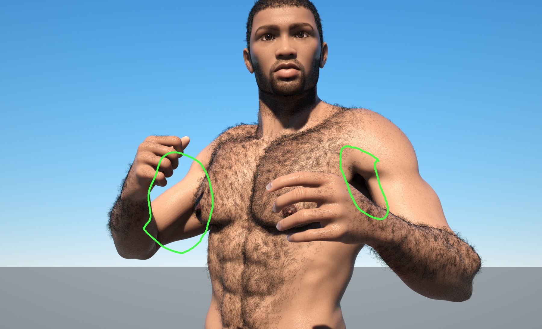

I am still observing the smoothing bug, but it only arises at certain viewing angles. I have as instructed set the Rounded Edge value to 0 for all materials in the Mix. In the example image below, in the areas facing toward and away fro the sun the smoothing seems fine but along the terminator it gets strange. This problems does seem to go away if I disable fake shadows. Thanks for your help. FYI I havent installed the very newest update, but I figured I fill you in i=on this now. I'll be installing the new one (.26) soon.
