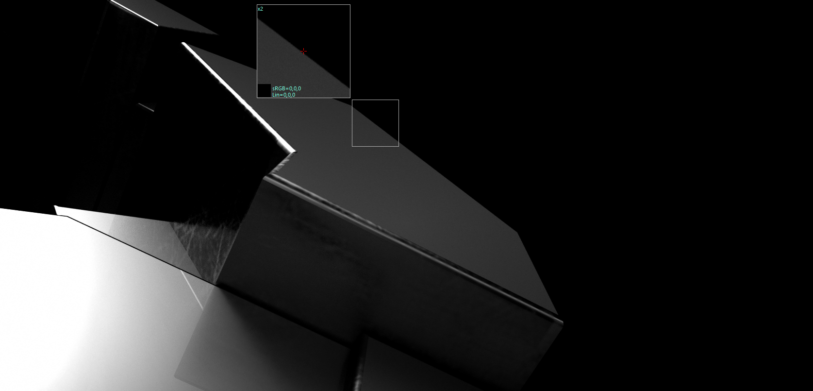

Hello, I get some glowing edges in octane for cinema 4d when enabling Alpha channel inside the octane settings below you can see a screenhoot. How can I get rid of the glowing edges ? When I disable the Alpha Channel i get no weird glowing edges. I want to composite the render later inside after effects to create a different background but with the glowing edges in the alpha render it looks very bad.

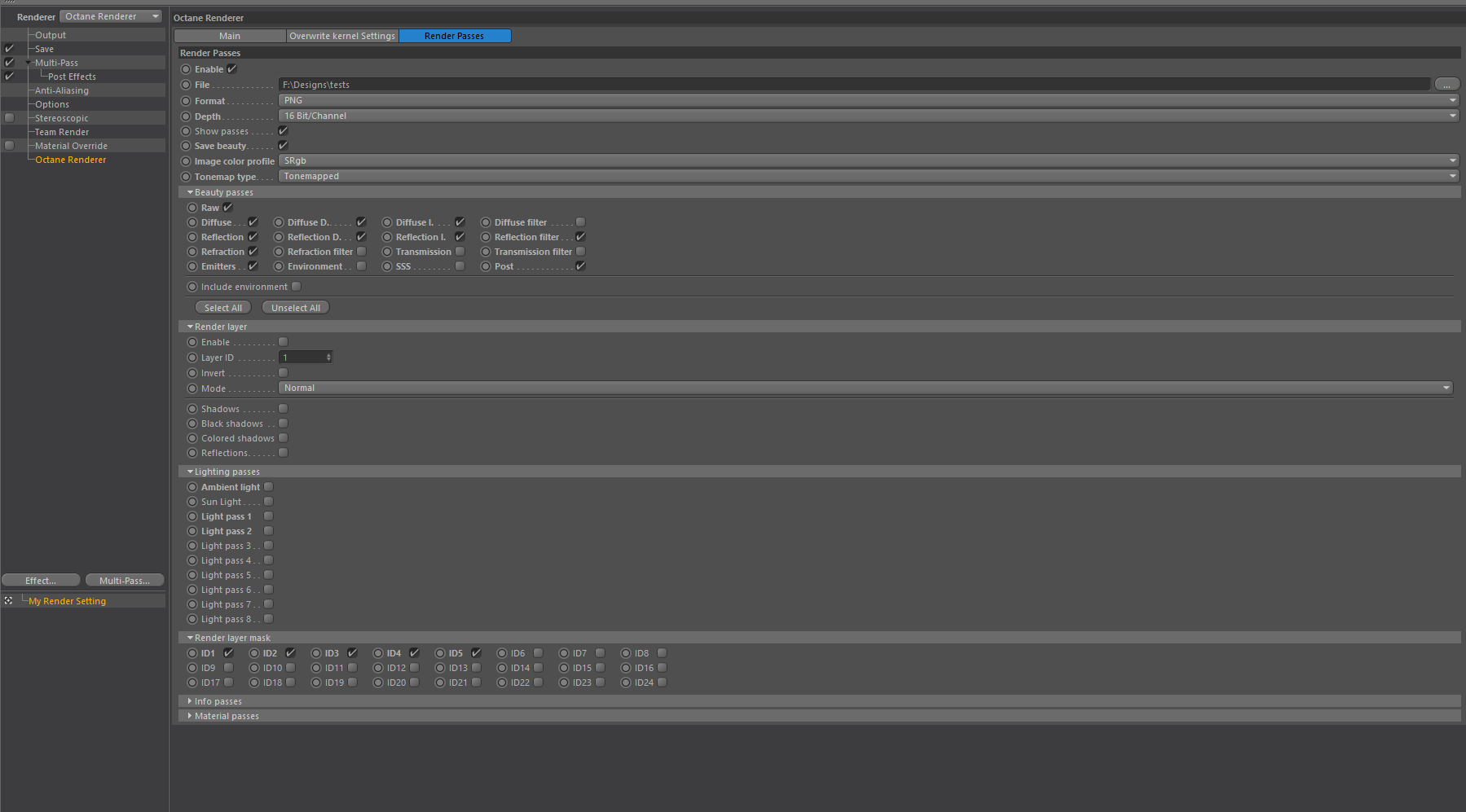

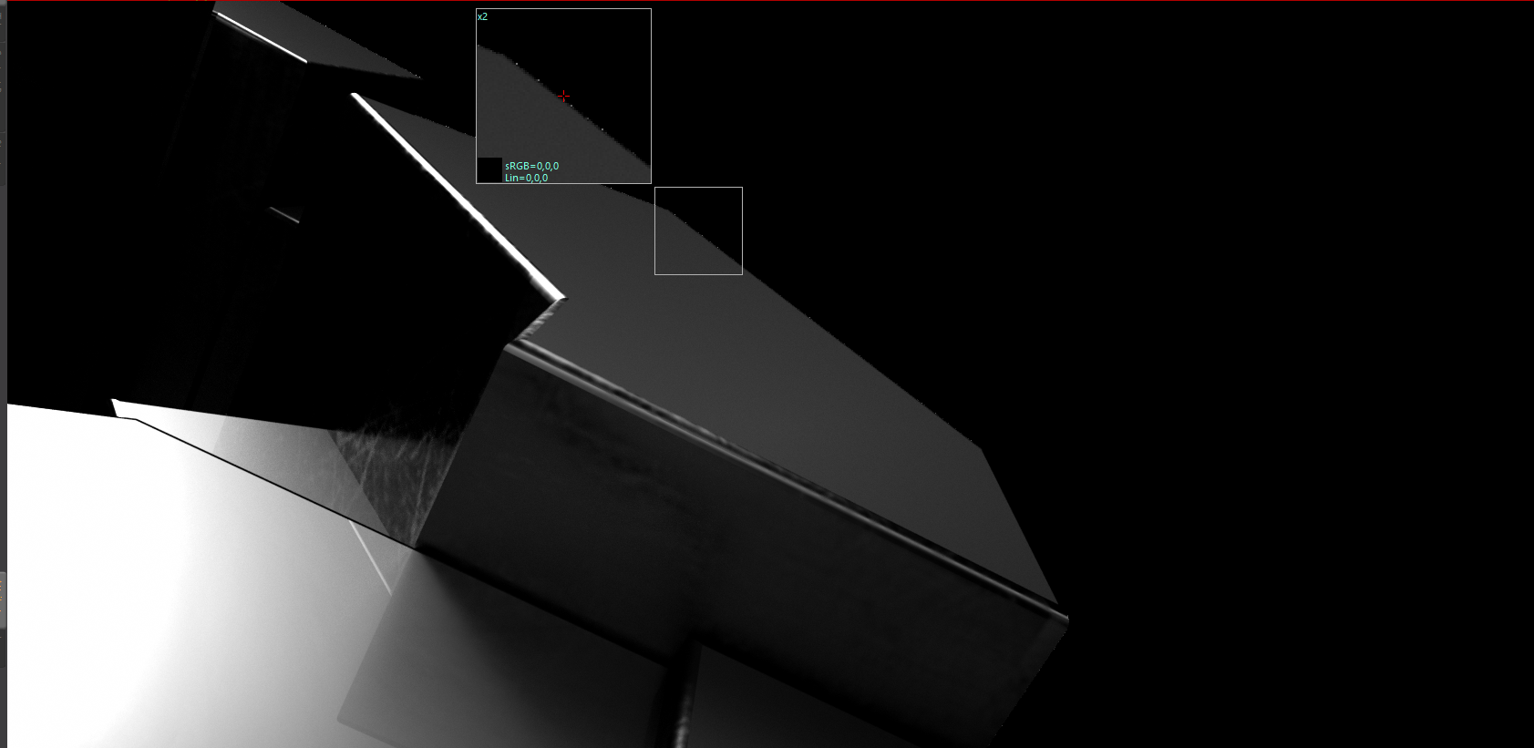

Hi Aoktar, I rendered now a scene and noticed that the pixelated edges still appere in the multipass render. I get the edges also when doing the compositing inside After Effects. It's very important for me that i have no pixelated edges in the final render, because I can't do a nice compositing with the pixelated edges. I attached also my render settings and what options i have enabled for the multipass.

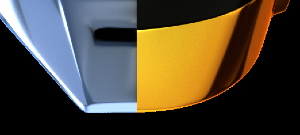

Here is the Scene File, I could not attach the file here in the forum because it's to large that's why the link. I noticed the hotpixels also on other projects. The scene file used to illustrate the pixelated edges, is created by Glass Hand Studios
I just used the project to do a test render and to illustrate the pixelated edges when I render in Octane.

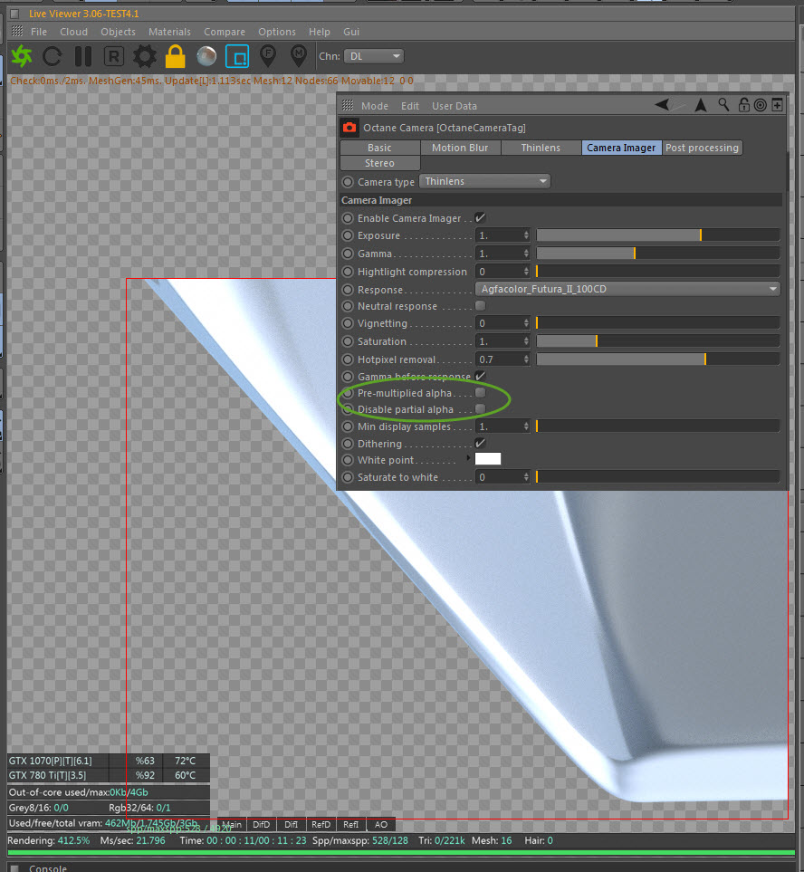

Your solution is in the attached image. Please investigate these parameters too.
