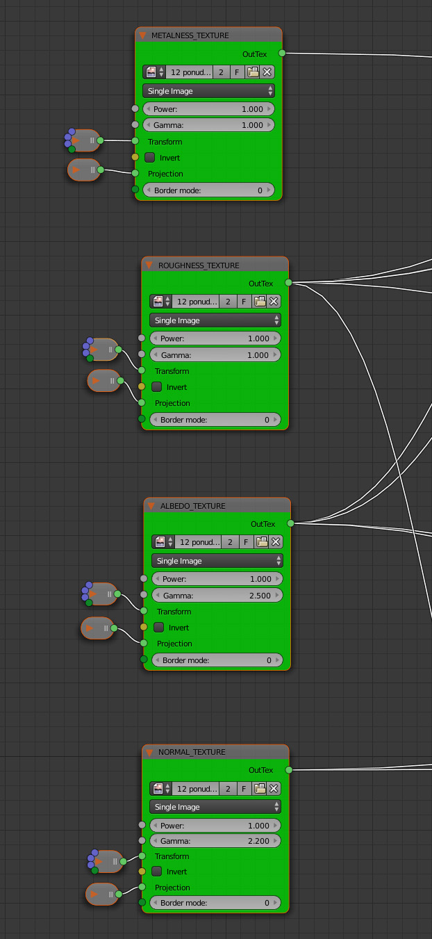

Hey Guys,
I have added the Shader for Blender in the main thread,
same workflow as in standalone,just reload the textures in the green Texture nodes and click render.

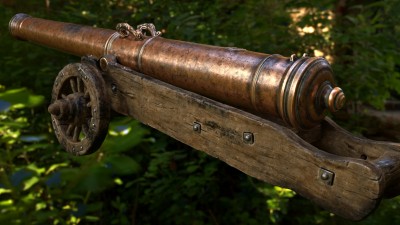

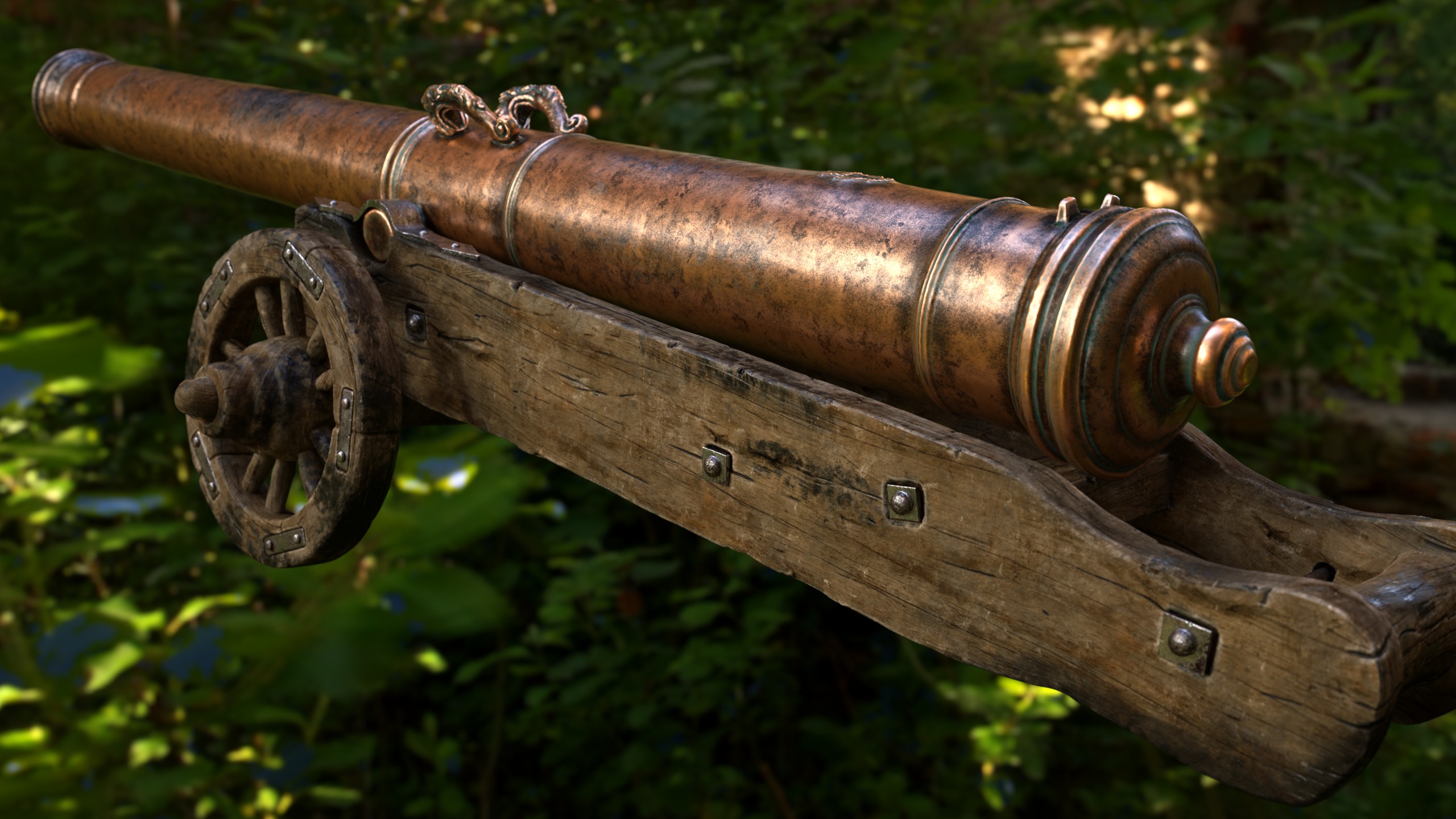

The Blender shader works great! Very clever setup. Thank you Miko3D! Example image, just plugged in the texture maps and did not change any settings. As can be seen wood and metal can be mixed with good results on the same UV map thanks to the metalness node.
