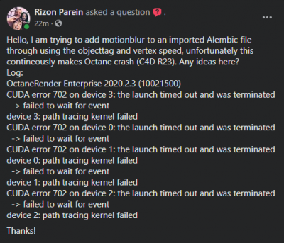

RizonParein
Posts: 28
Joined: Tue Jun 09, 2015 10:47 pm
Thanks Tom!
Just installed latest plugin and standalone, same problem.
OctaneRender Enterprise 2020.2.4 (10021600)
CUDA error 702 on device 3: the launch timed out and was terminated
-> failed to wait for event
device 3: path tracing kernel failed
CUDA error 702 on device 1: the launch timed out and was terminated
device 1: path tracing kernel failed
-> failed to load symbol data to the device(deep_data)
device 3: failed to upload the deep params
device 1: failed to upload the deep params
CUDA error 702 on device 2: the launch timed out and was terminated
device 2: failed to upload the deep params
CUDA error 702 on device 0: the launch timed out and was terminated
device 0: path tracing kernel failed
device 0: failed to upload the deep params
mojave
Posts: 1441
Joined: Sun Feb 08, 2015 10:35 pm
RizonParein wrote:Thanks Tom!
Hi RizonParein,
Could you share the driver version as well as the HW you are using?
If you can reproduce this with a scene you can share (or a simplified version of it) please send a PM and will look into it.
Thank you.
