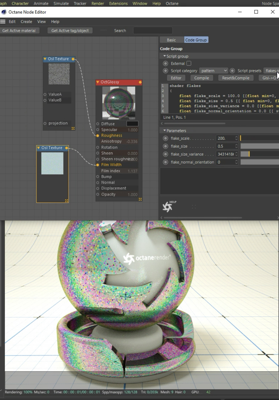

you definitely need a more complex material than this, but you could start by adding an OSL texture/flakes.osl to the Film width pin of a Glossy or Metallic material:
