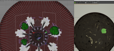

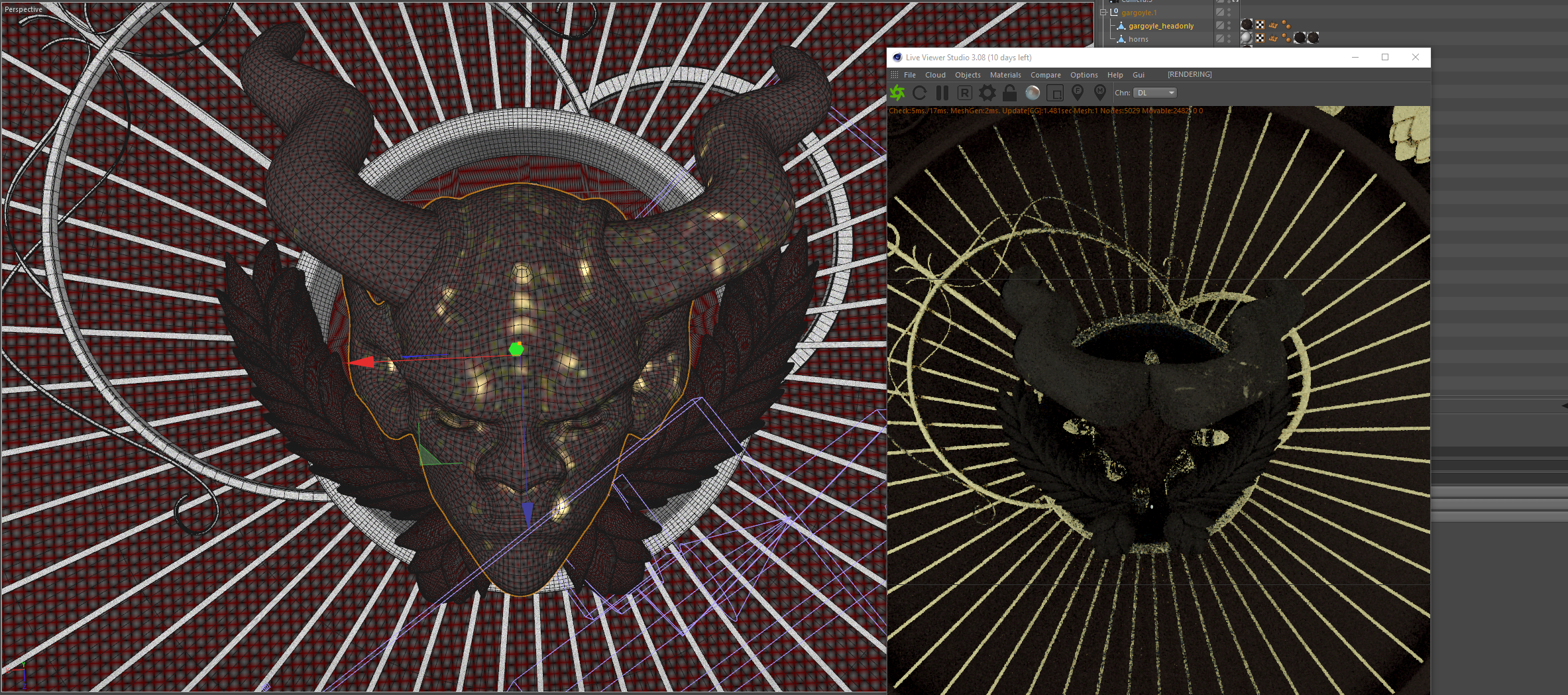

Maybe I misspoke? It's the gargoyle model in the image I attached. In the image is a comparison of the scene and the octane live viewer.

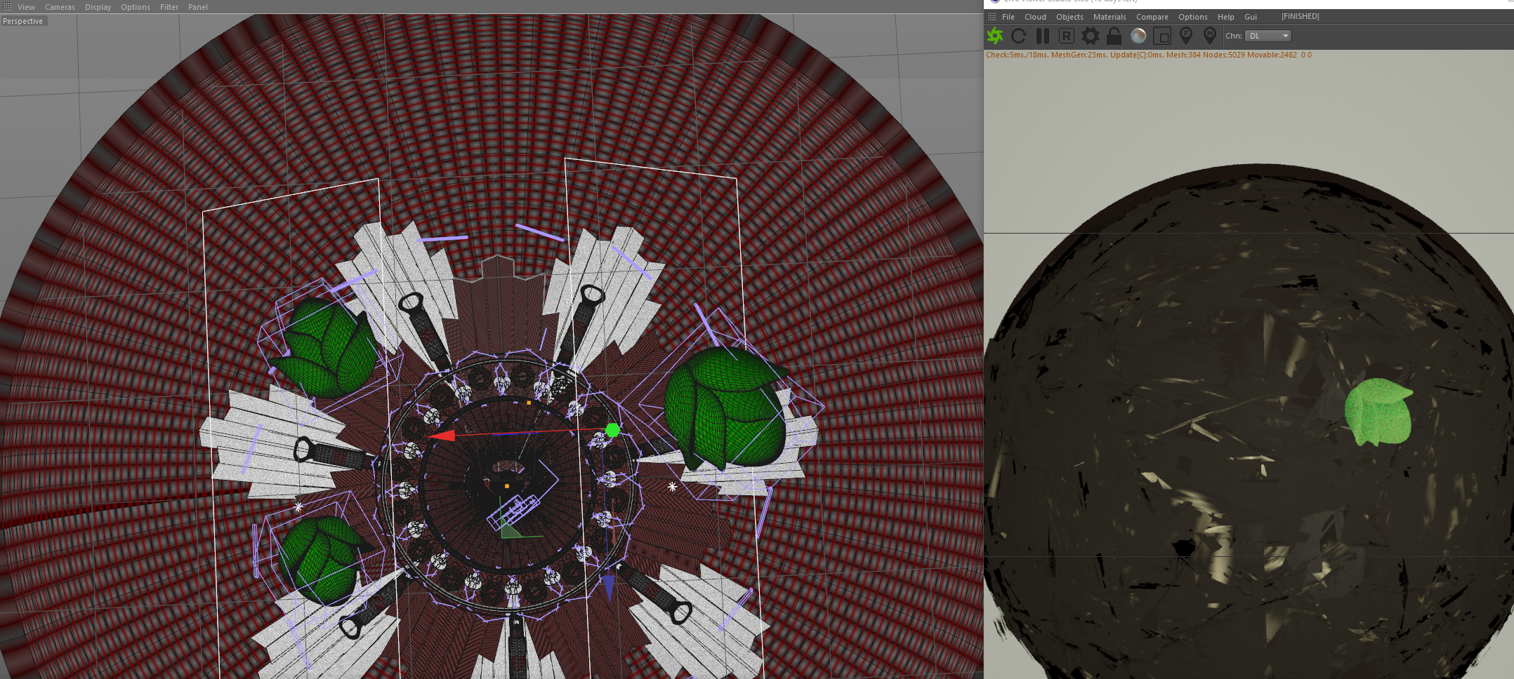

so i zoomed far out and crazy things are happening! In the image you can see in the live viewer a mass that isn't in the scene. That glitchy mass looks like a jumbled up mess of the texture that's on the missing object. In the scene you can still see the gargoyle head in the very center of the scene.
