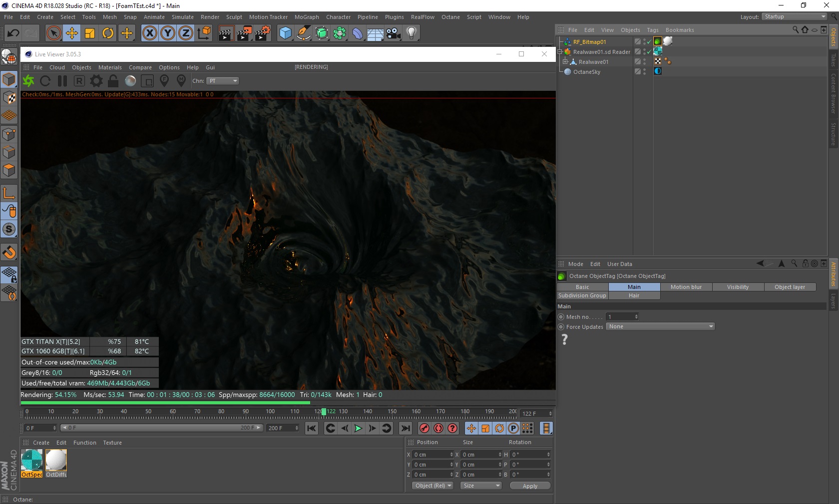

I have imported some foam particles from real flow to c4d via Real flow particle importer and i used an object tag on top of of it, but it wont show up in render?

Do you see particles tab activated in object tag? How is your object setup? Any pictures pls.
Actually very simple setup, just a RealFlow SD importer (which has my Real Wave Data) and RealFlow Particle importer (Which has my foam data in .bin format)
and an Object tag on top of my RF particle importer but no particle tab activated in my object tag.
And no foam shows up in my render view

It's not a type which is supported by particle engine of plugin. Anyway you can use a way as using standard geometries.
Thanks for your help dude, but I don't understand what did you mean by using standard geos. Actuallyaoktar wrote:It's not a type which is supported by particle engine of plugin. Anyway you can use a way as using standard geometries.
