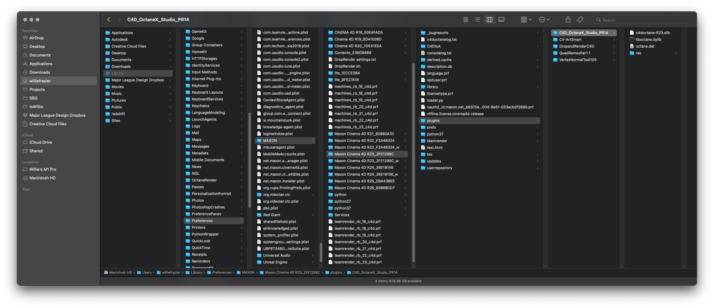

- Copied the C4D_OctaneX_Studio_PR14 folder to the User -> Library -> Preferences -> MAXON -> Maxon Cinema 4D R23_2FE1299C -> plugins folder
- Removed unrelated .xlib files, leaving only
- c4doctane-R23.xlib
- lib octane.dylib
- octane.dat

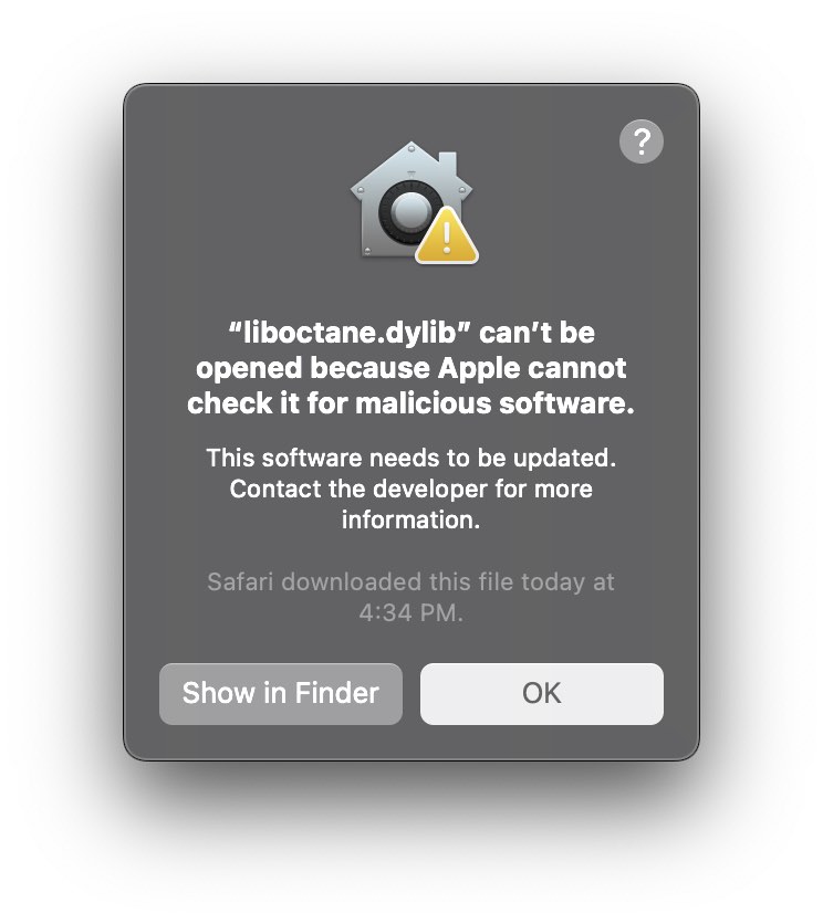

Of note, I was getting the customary 'cannot be opened because... unidentified developer' message for the .xlib, BUT the message I got on the .dylib file was different in that the dialogue states that it needs to be updated. My first launch worked without the dylib being loaded, but after clicking the 'open anyway' in system prefs, and relaunching I now get the crash dialogue from Cinema seconds into the launch sequence - pretty much the instant the splash screen comes up.

Plugin Install Path
Plugin Install Path
dylib error dialogue as referenced

Alright, after some more digging, I found that I needed to install the plugin in the Applications -> Maxon Cinema4D R23 -> plugins folder rather than the one I placed it in yesterday. It would be helpful - in the absence of a an installer - to include a readme with instructions. I had to search and found a video which gave me the wrong advice leading me to install incorrectly.
