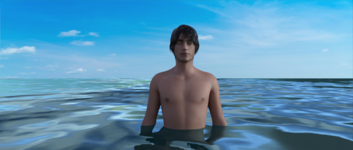

I rendered a scene for the first time in Octane render but it is not up to my expectations.
Because when I render it in Nvidia Iray , it looks like this :
And when I render it in Octane, it looks like this :
I want the water to be lazy and the reflection of the figure on the water (just as in the Nvidia Iray render)

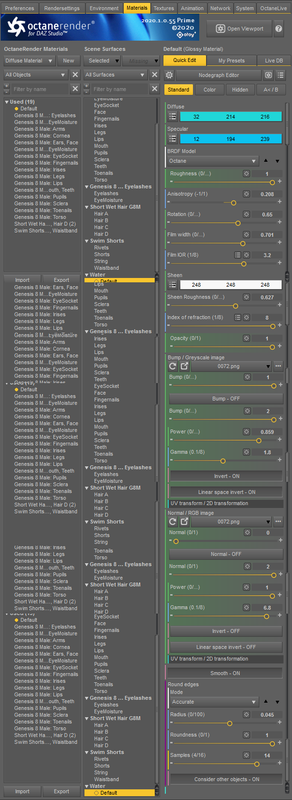

Here is the Material Settings :
Posts: 10626
please try to change the Roughness from 1 (full matte) to something like 0.003 (full glossy).
