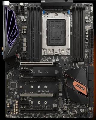

I work for a vfx company and currently only use cpu render node.
I want to build a 4GPU machine to test out octane.
Here is the build: https://uk.pcpartpicker.com/list/cDcMp8
CPU: AMD Threadripper 2950X 3.5 GHz 16-Core Processor
CPU Cooler: Noctua NH-U14S TR4-SP3 82.52 CFM CPU Cooler
Motherboard: MSI X399 SLI PLUS ATX TR4 Motherboard
Memory: Corsair Vengeance RGB Pro 64 GB (4 x 16 GB) DDR4-2933
Storage: Samsung 970 Evo 500 GB M.2-2280 NVME Solid State Drive
Case: Corsair Air 540 ATX Mid Tower Case
Power Supply: EVGA SuperNOVA G2 1600 W 80+ Gold Certified Fully Modular ATX Power Supply
I will then add in the 4 GTX 1080s I have spare.
All the research I have done makes me believe this will work and use the 4 gpus optimally.
Looking for confirmation or to be told why this wont work and what I need to get 4 gpus into one machine.
Thanks in advance!

Yes this will work fine if You have blower style 1080tis.
Overall, at least for OctaneRender You do not need this high end build if You plan to use it for OctaneRender only, but it will work fine.

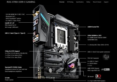

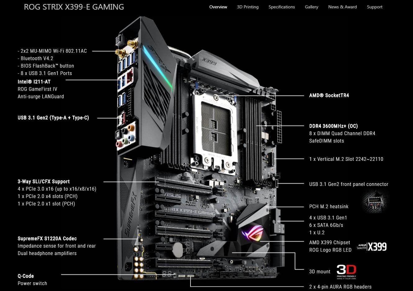

I have the same CPU and a motherboard S-TR4 X399 ASUS ROG STRIXX399-E.
This rig I bought has had 1x RTX2080TI 11GB ASUS.
From old pc, I have 3x Gforce GTR 1080TI. My intention was to take these cards later to the new board.
Now my pc dealer says to me, that I can only take two from my GTR1080TI`s to the board with the RTX2080.
So I was a little surprised that you can take 4gpu. I have no knowledge about the exact details to handle more
gpu`s on the same board.
Perhaps ther is a difference between our motherboards I cant see in the specifications we have posted.
I should wait with the modification still I get more information about my abilities.
Thanks also!!!

Your card is not the same, it's just based on the same (x399) chip. Among other important difference Your have differently spaced PCIe slots that physically do not allow 4x double slot cards being placed..rocktron66 wrote:
