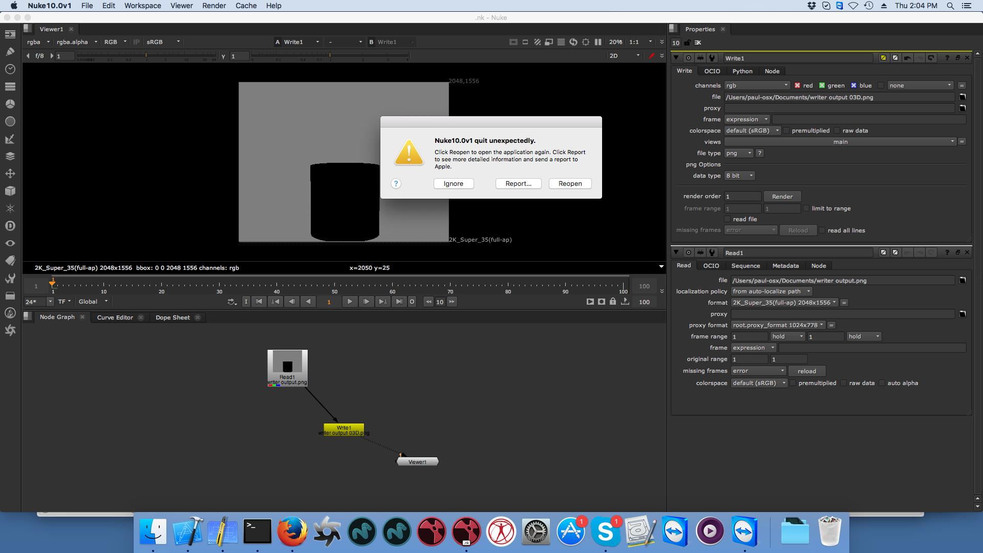

Hi Jason - I am not able to reproduce this problem. On Windows I get no error. On OSX I get Nuke reporting a crash, but it does not actually crash and the dialog can be ignored. If I remove the OctaneRender node from the scene completely I still get the crash msg. So is it possible this is a general Nuke bug rather than specific to the plugin?

You can see even this simple scene is crashing for me on OSX when rendering in the background and has not Octane nodes in it.

Hmm. Interesting. I'll investigate this some more.
