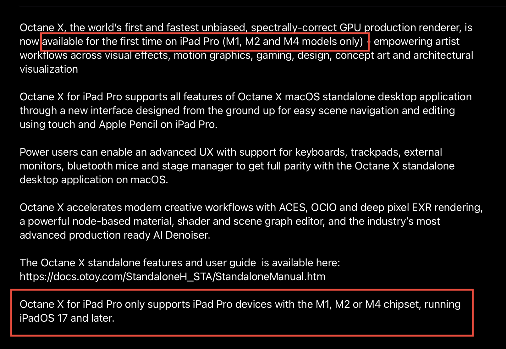

I installed Octane X on my iPad but when I open it, it says unsupported GPU found. I have an 8th gen iPad with the A12 chip in it. The page on the app store says Octane is supposed to be compatible with the A12 Bionic chip. What is going on?

Hi Mike,
Sorry for the confusion, the Compatibility chart is not correct.
Unfortunately, you need an Apple Silicon M# chip to be able to run OctaneX on iPad.
This is taken from Apple Store OctaneX description:
ciao,
Beppe
