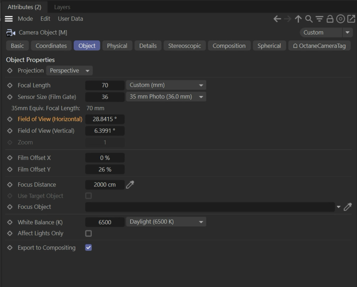

Hi, Yes exactly. I will try that method. But C4D Octane version doesn't have "Scale of View" option...
Architectural Visualizations http://www.archviz-4d.studio
Posts: 10646
For c4doctane, you can do the same in the Field of View (Horizontal) value of the C4D Camera Object:
H-FOV * New res / Old res
ciao,
Beppe
