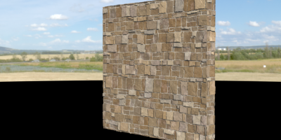

A.Lopez
Posts: 60
Joined: Fri Jan 21, 2022 4:20 pm
Hi Jobigoud,
today I've spent my time creating a procedural stones wall (the one attached) and I've understood the issue.
The model in the image is 300 x 300 cm. The texture map is 300 x 300 cm. So, as you can see in the image, there is no issue.
But...the problem starts if you want to apply the material to a bigger object, for example, a model of a wall of 600 x 300 cm.
In that case, all the channels except the displacement work procedurally. Unfortunately, the displacement now needs to be baked to work with a procedural texture as input. So, baking it, You will have the displacement that will repeat the baked image, while the other channels are full procedurals and they haven't repetitions.
So the BIG problem to me (because I've created the procedural stones wall to avoid maps repetition, lol), it's that I need to bake all the channels! In this case, the problem is solved (but I have repetitions!).
Why texture displacement doesn't accept the procedural textures as input without baking them? To me, this could be a killer feature of octane.
Roy
