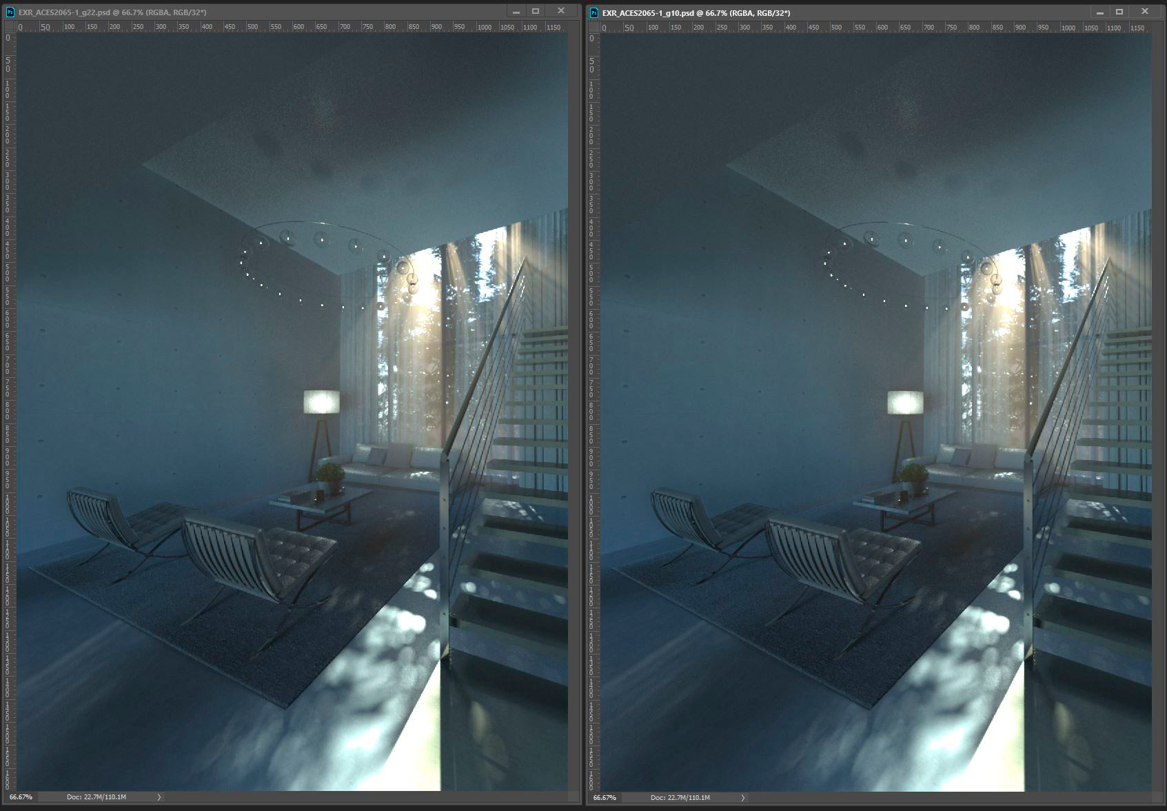

for example an ACES image(exported by octain render 2020.1.XB2)can be well recognized by using ACES-elle-V2-g22.icc 1:Aces2065-1,
2:assigned "ACES-elle-V2-g22.icc", which will look same as the "linear" export
3:adjust the gamma to 2.2 (which is lost when otoy export the image, that makes the image far different to what it should be.)
4:original looking from Octane render's viewport(for compare)

For Elle Stone's ICC profiles you should be using
So then the steps are: export EXR in ACES2065-1 from Octane, load in Photoshop, assign any ACES2605-1 ICC profile (e.g.
ACES-elle-V2-g10.icc, which has no gamma (i.e. linear). Then you will no longer need to use step 3 to unapply the gamma transform. In general for any EXR file only the g10 files should be used, because all EXR files are linear.So then the steps are: export EXR in ACES2065-1 from Octane, load in Photoshop, assign any ACES2605-1 ICC profile (e.g.
ACES-elle-V2-g10.icc).OCIO WORK FLOW2

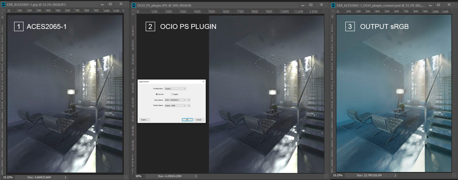

As mentioned here, there is some tools for OCIO
Using the OCIO plugin for photoshop to converting OCIO image to sRGB 1:Aces2065-1,exported from Octane Render 2020.2 XB2jimho wrote:
- to download the latest OCIO-configs here, ACES 1.2:
https://github.com/colour-science/OpenColorIO-Configs- OCIO for photoshop
http://fnordware.blogspot.com/2017/02/o ... oshop.html
2:from the ps filter find the OpenColorIO,within the plugin UI indicate the OCIO configuration which is downloaded from the above ACES1.2,then choose convert from ACES2065-1 to output sRGB
3:the result of "output sRGB"
The comparison of results, 1:the icc workflow result: assigned "ACES-elle-V2-g22.icc",
2:OCIO plugin convert result
3:assigned "ACES-elle-V2-g22.icc"+ manually adjust gamma to 2.2, as mentioned the gamma is based on imgae node
4:Octane Render 2020.2 XB2 Viewport effect
Obviously, the OCIO relys on the work flow the result is not consistancy.
This is the reason I mention the Adobe icc solution is more reliable.
