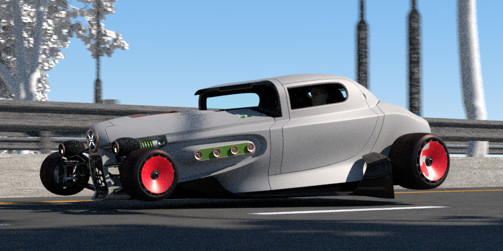

I have set up an animated spinning wheel in modo an exported the scene into Octane. When I render it there the wheels shrink in diameter. The more I set the motion blur, the more they shrink. Any suggestions for a work around?

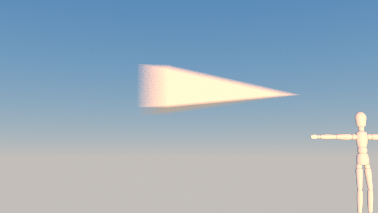

Here is a real world example.
Everybody knows that if you want to avoid motion blur on the fast moving object while camera moves with it, then you should attach camera to that object.
Now let's imagine that we want camera to approach a moving object, then travel some time next to it, and then focus on something else. This is how it will look in a 3D editor:
And here is how it looks in the render: the flying object is blurred all the time, and the guys are not at all.
This is the case which I couldn't solve with Octane. There is just no option to render this properly. I also noticed that in simple test scenes Thin Lens camera will render it properly. But if the scene gets more complicated — the higher chance that there will be mistakes in the render. But the Universal camera always renders wrong motion blur.

Thanks for the ideas. Everything in my scene is fixed and the only thing animated are the spinning wheels. I know the pivot is correct as it renders correctly in modo and the wheels are shrinking here in Octane around the correct centers. Maybe I can try a simpler locator grouping in modo before export to Octane.
