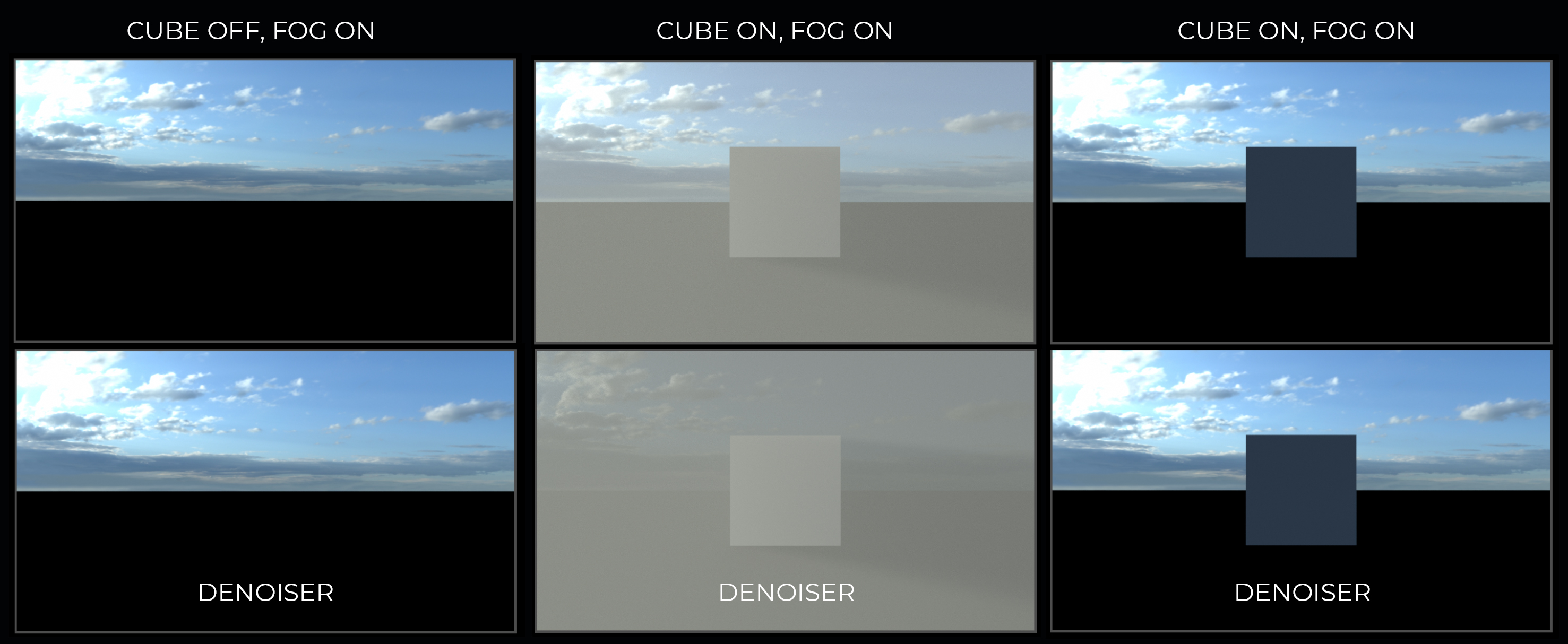

Just sent you a DM bepeg. If it helps anyone else the FOG volume withing a HDRI object seems to be the culprit in some way (in conjunction with Denoiser)
(All within C4D)
With the image below, the last column is meant to say fog OFF.
(All within C4D)

thanks for sharing the scene.
The issue is with Environment Texture node, with Medium node connected, and Denoiser active in 2020.1.
I have already shared the scene with the core team for the fix.
ciao Beppe
ciao Beppe
