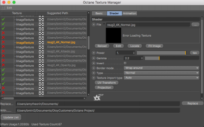

unfortunately you have not shared all the textures, so it is difficult to say:
Next time, please, save the project with assets, in order to collect all the textures before sharing.

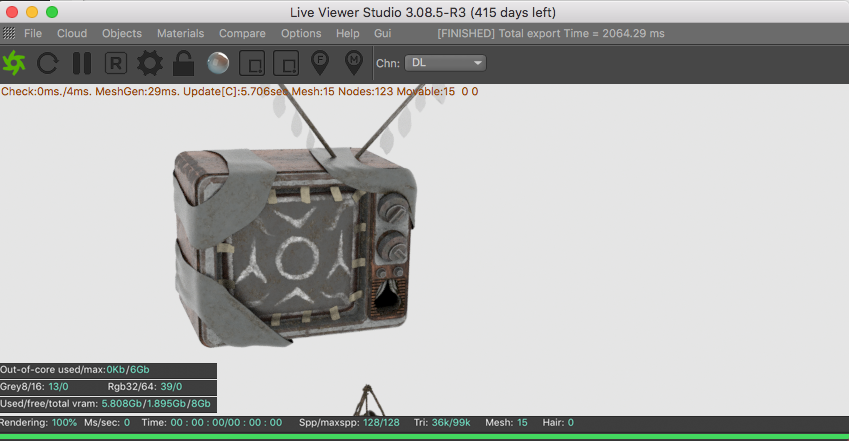

At the moment the scene takes ~5.8GB of VRAM, and renders with no issues here, in both 3.08.5, and 4RC7:
ciao Beppe

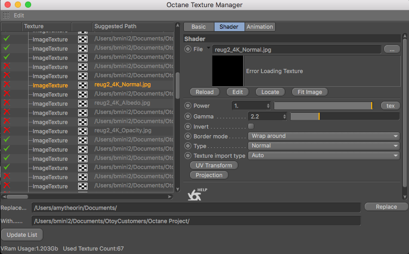

ktheorin1
Posts: 43
Joined: Sun Oct 02, 2016 10:03 pm
The textures that aren't connected are for objects that aren't in the scene. The two specific objects with 8K textures that seem to be causing the issue are "Screen" and "Brown"
