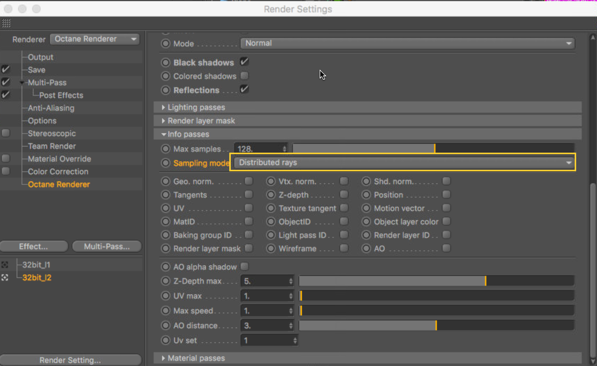

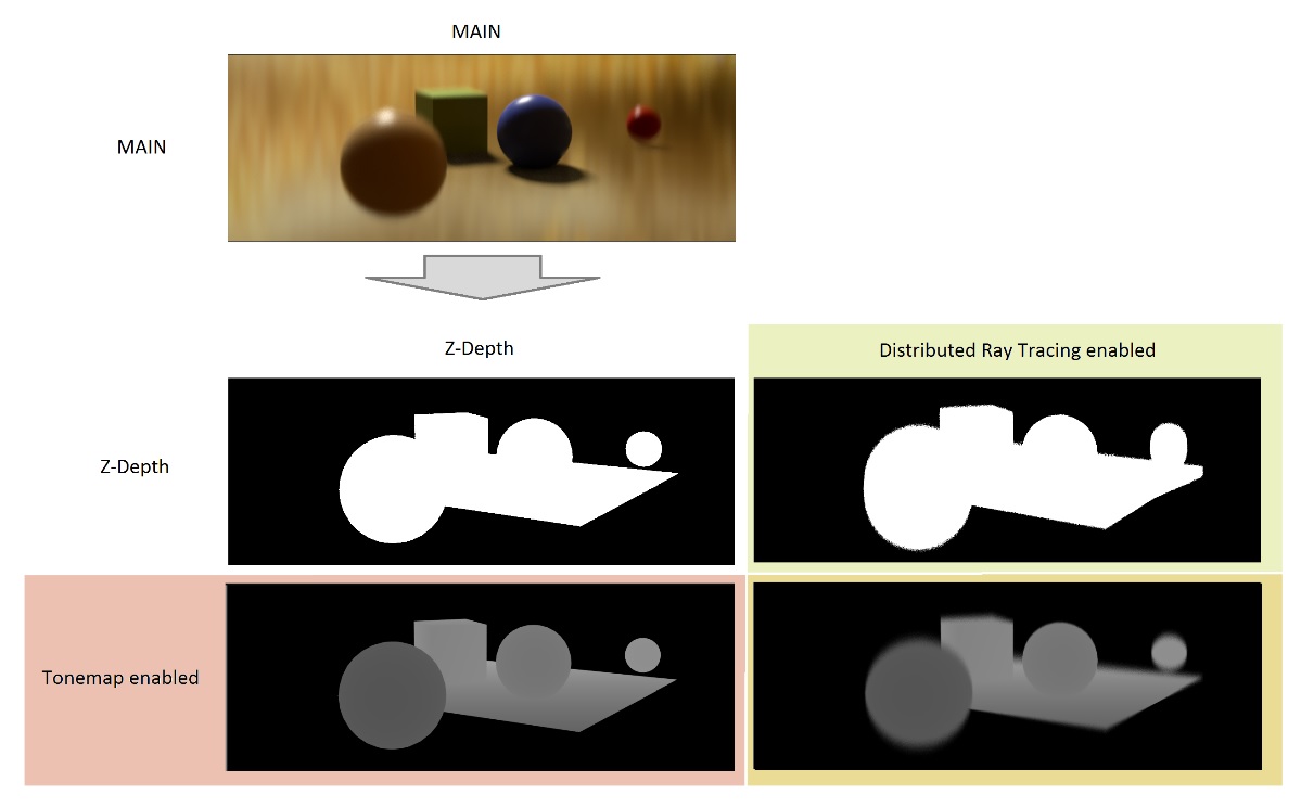

what are you settings for the Info channel passes?
You need to have the Distributed ray tracing active:
Please, have a look at this picture:

Thanks for the reply.
I have tried the three different sampling modes under Info Passes. They are all seem the same.

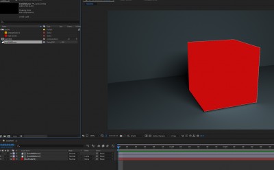

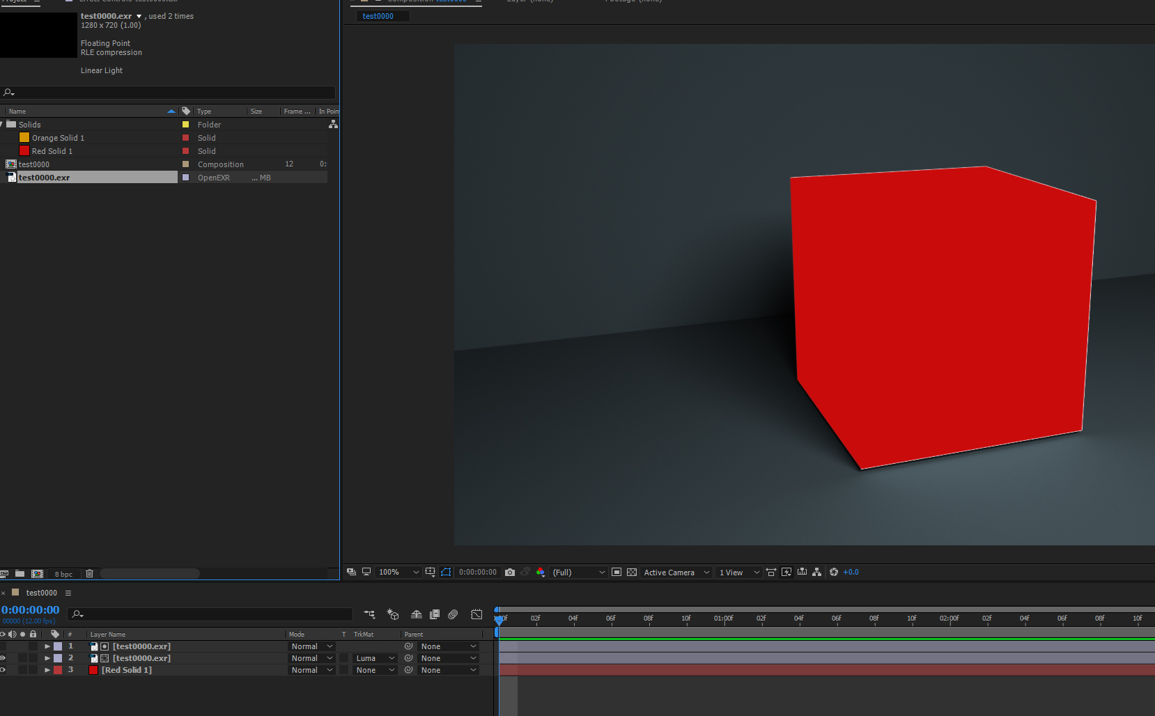

I have potentially discovered the problem, and I would like some clarification.
Okay, so luckily this is probably just user error and I think I'm close to figuring it out.
The file that C4D saves is a Floating Point+ (premultiplied) .... and that file has a good alpha that I can use in After Effects (the border is gone). However, the one that is rendered out from having Render Passes enabled is only labeled as "Floating Point" and that has a black edge around the transparent parts.
How do I get the Render Passes file to save with premultiplied alpha? I have alpha checked in settings, and premultiplied alpha checked in camera imager.
A lot of the videos I've watched online say to disable the Save Multi-Pass Image that C4D produces.... but it's giving me the correct Alpha whereas Octane is not.
So, what might I be doing wrong?
