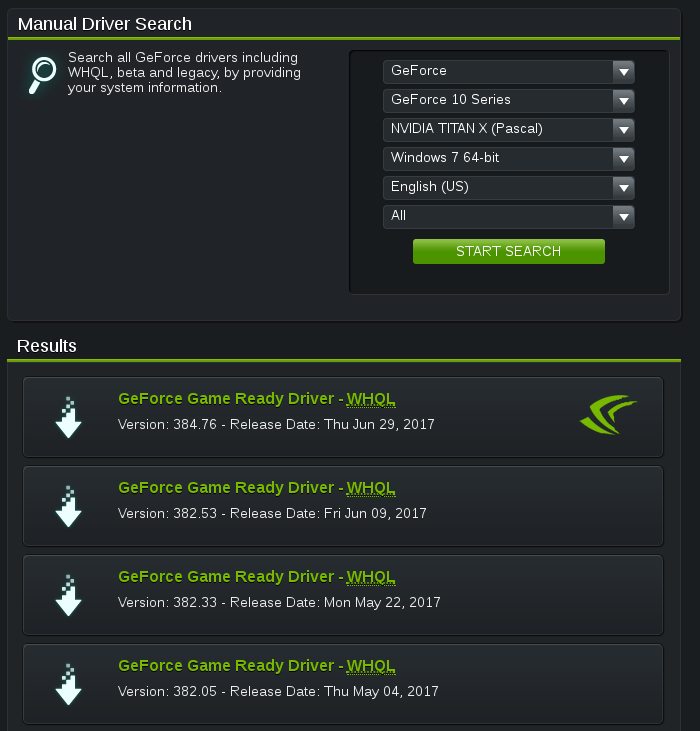

Hi again, you cant update Cuda, the next version 9.0 is not even Beta.
I checked manual search for Titan X and I got no problems to find.
Cheers, mib

Ok...I see that Titan is under Series 10 cards. Would have been nice to know that from Nvidia.
Doing a general website search for Titan X driver comes up empty.
