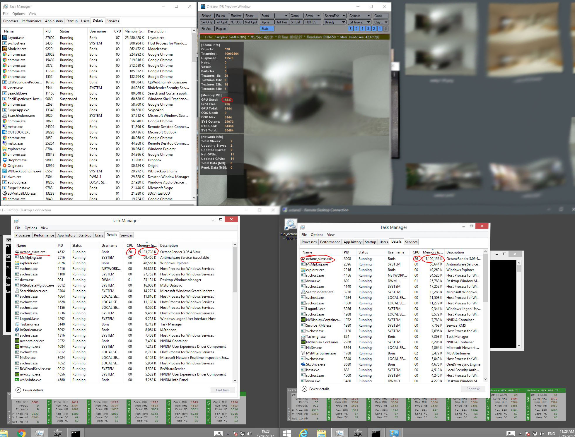

You need RAM on the slaves. For the 4233 MB GPU RAM scene you need 5300 MB system RAM on the slaves. I guess 16GB system RAM is recommended so you could use 12GB card to its full RAM potential.
CPU usage on the slaves went from 2 % to 35 % during rendering. It started at 2% and then gradually climbed to around 35% in a period of 2 minutes and then stayed there until the rendering was finished.
Initially I had shitty Celerons inside slaves since i thought this was a GPU renderer but then swapped them with i7-4760 @ 3.6 GHz because of heavy CPU usage.
Celerons were climbing to 70% or even more.
This CPU usage is not consistent, sometimes slave CPUs stay below 7% but you can see from the screenshot they can be high too, this is not clear to me.
