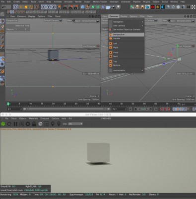

Hello, I've Google but found nothing of what I was looking for. Is it possible to lock the Octane Live Render View-port to a camera specifically but then in my C4D view-ports move around freely without having to be in the camera?

Does this mean it'll disable any further renders? As I want it to still render, I just want to have it stuck on my Octane camera instead of my perspective camera.

Majority of the time I like to work in the Perspective mode and only use the other three if I'm aligning something. In the picture below is an example to clear up what I exactly mean if there's any confusion.

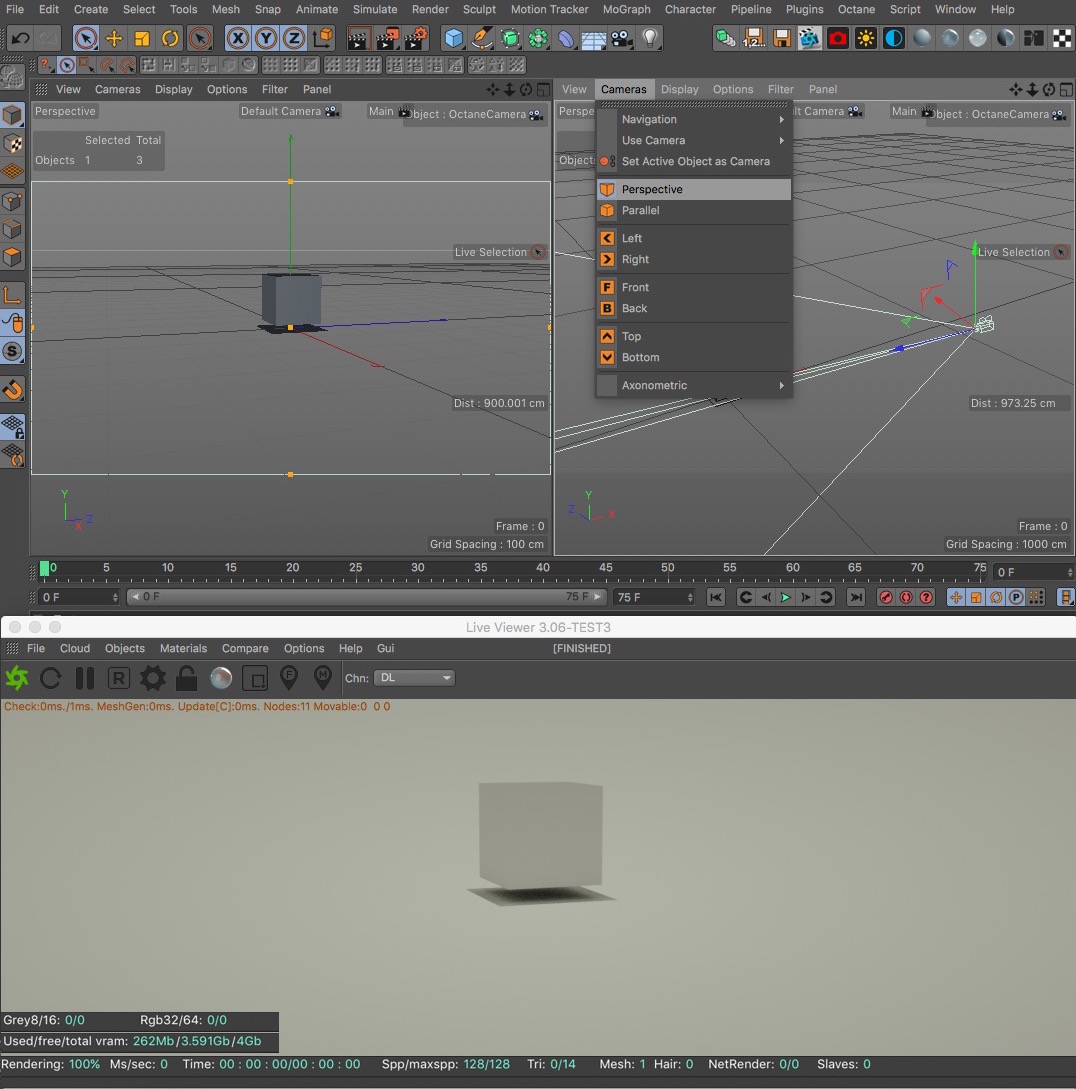

Posts: 10550
Hi ErraticFox,
you can have up to four different perspective view in viewport:
