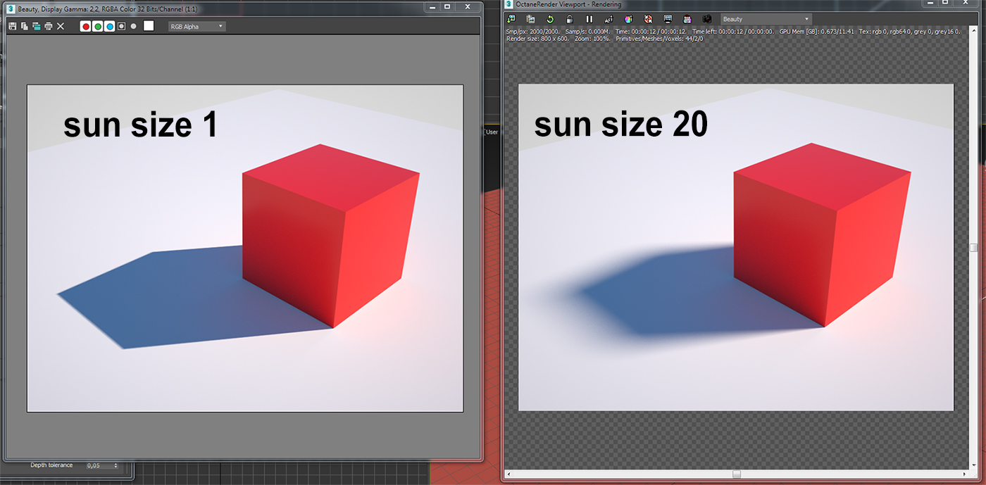

Getting the right HDRi is only your first step, so lets assume you have the HDRi you need already and focus on the daylight system.
When you are using the daylight system, like paride4331 said, increasing the sun size will make softer shadows (just be aware that the sun will also increase in size and can look quite odd so keep the sun out of the camera, in my opinion).
To make the lighting fit more with the overcast, dim, look, you will want to play with the sky turbidity slider. Decreasing the Turbidity will make the light and shadows of you scene more contrast. So the light hitting objects will be brighter. When you increase it, the light and shadows do not contrast as much, which can help make your scene look over cast. I usually use this setting when making a cloudy scene or pollution filled environments.
Then, you will need to play with the sun and sky colors to match, which is all preference, depending on what you need in your scene.
