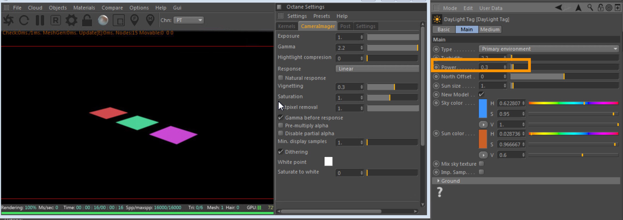

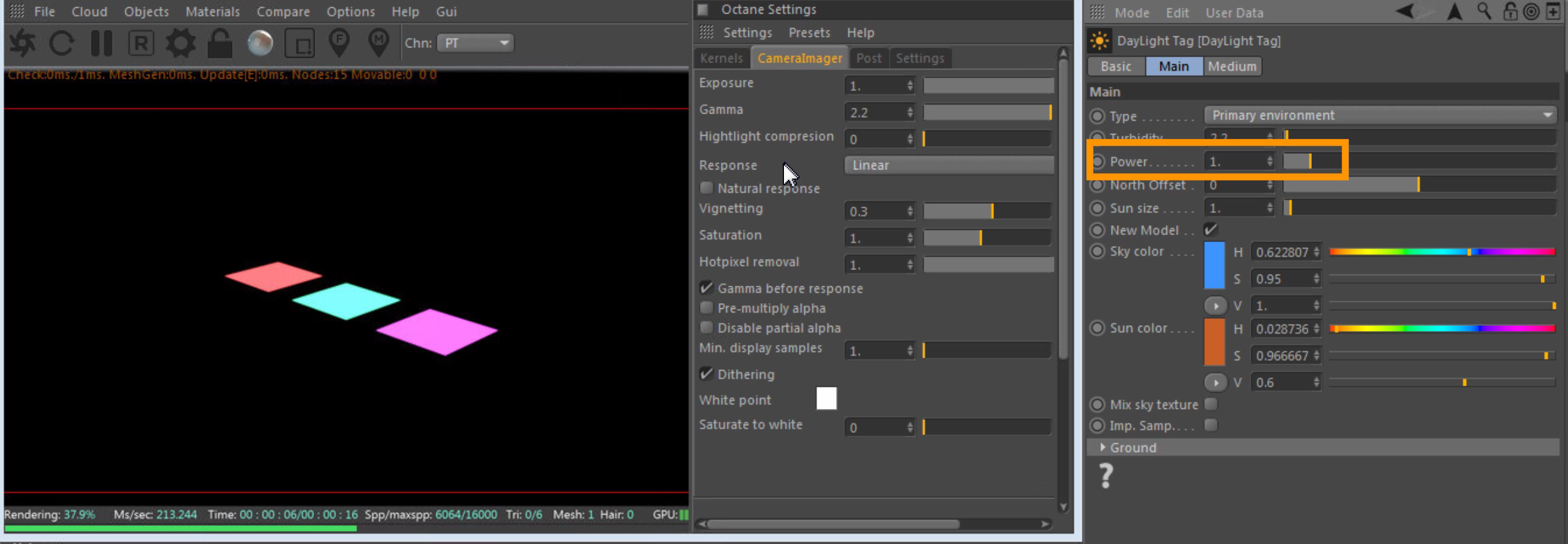

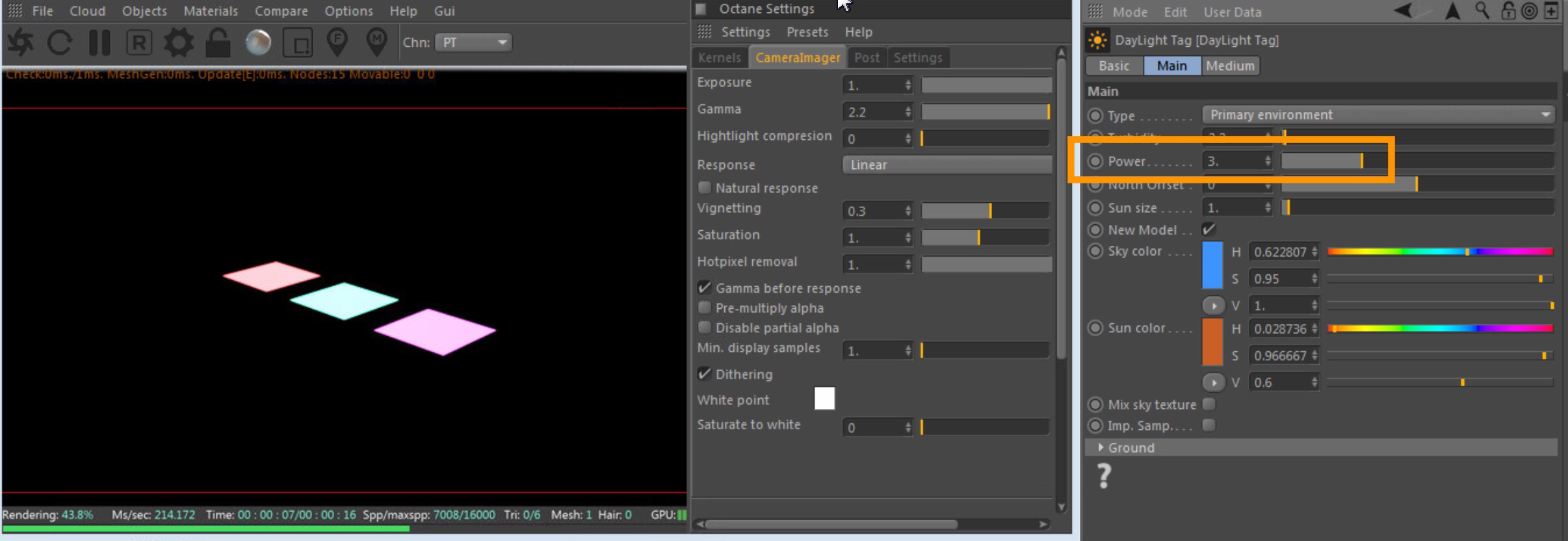

Interesting, but look at this:
ciao beppe
rightbepeg4d wrote:Interesting, but look at this:
but the
saturate to white setting is a naive way to deal with this problem, and can't achieve the same result.filmic blender try to deal with this problem automaticaly in a way that seems natural to the eye, emulating the smooth curve response of an analog film.This problem is usually treated at the post-production stage to get the right "look",
the advantage to have it as an OCIO config is to get the exact same result in every software in the rendering pipeline, for example same look in Maya and Nuke.
n.b : OCIO is also needed for example to support the ACES workflow.
