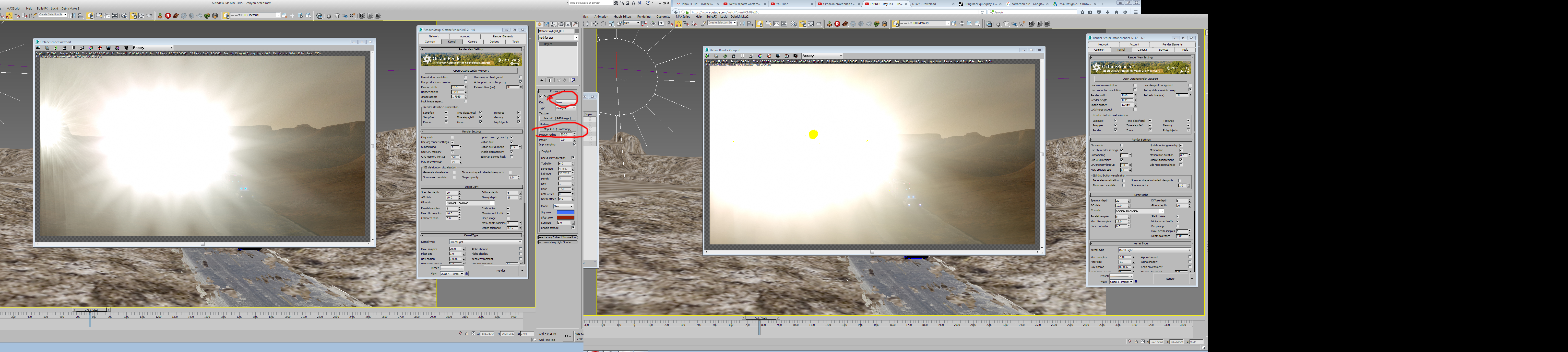

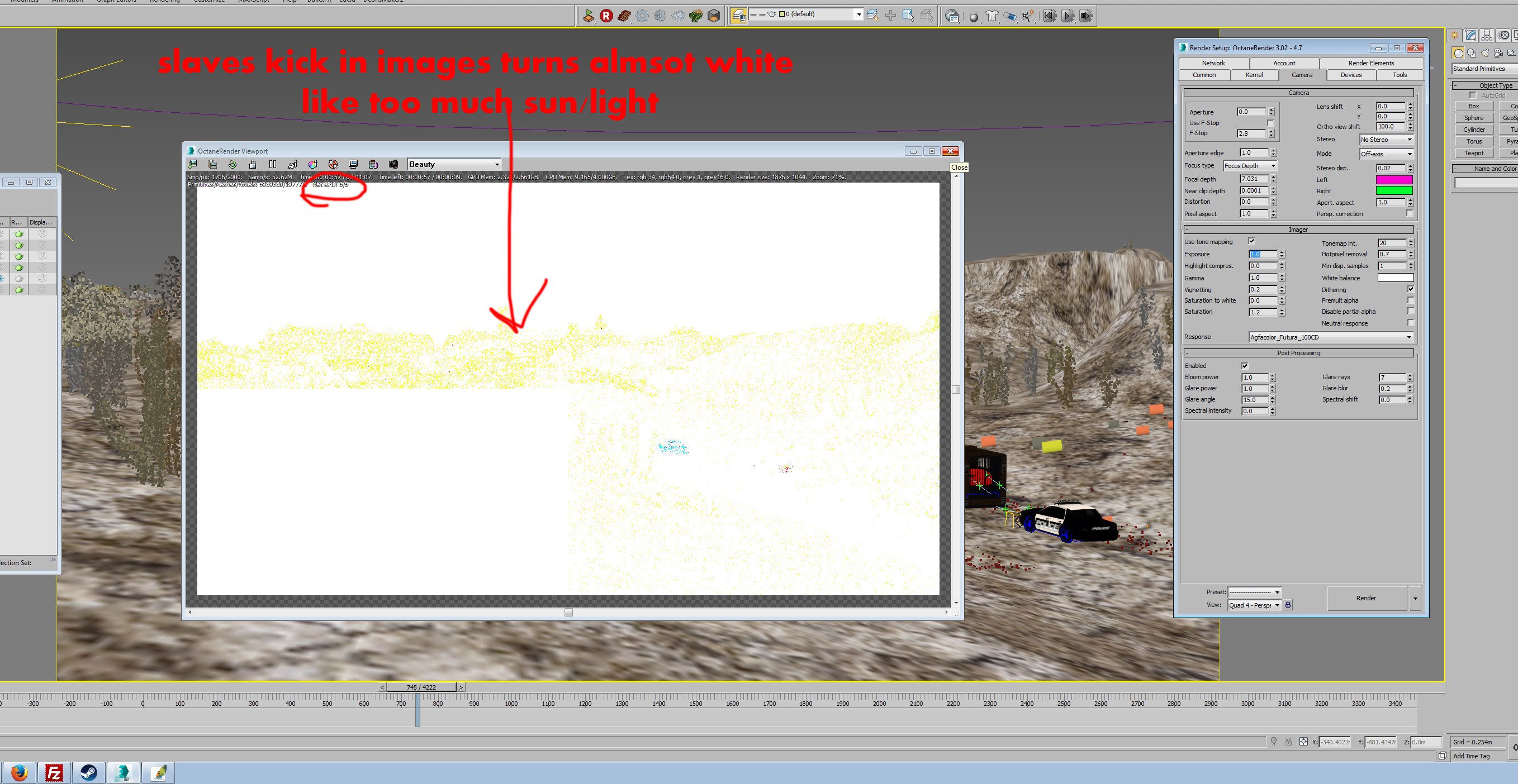

We use 3ds max plugin For some reason when octane slaves kick in Octane viewport turns white and it renders white. (very overexposed ) Why is this?
slave version 3.02

seems like all this happens when i am using scattering medium With sun kind - MAIN Type - Daylight or texture
Sun just gets very bright until screen turns white. This happens only when slaves are rendering too.
When scatering medium is empty it works
We tried the latest version same

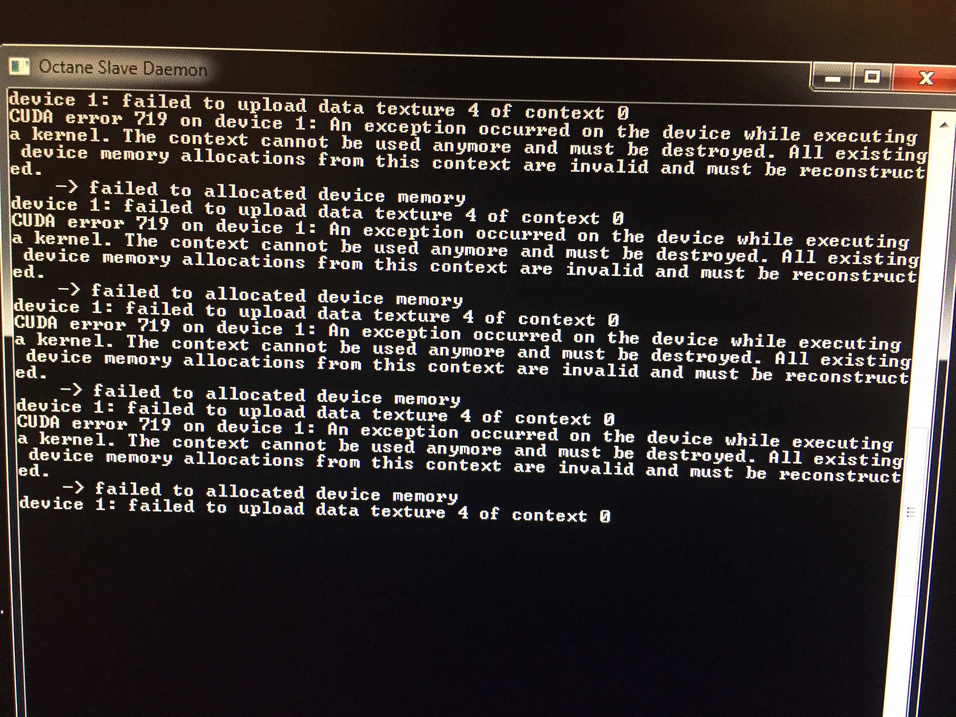

Also we get instant errors on slaves (see attached) but they continue rendering

same error - My GTX 780 Ti Classy was bad -> RMA.
Your videocard(s) may has/have VRAM issue, very sorry. ;)

Slaves render fine with 2.23.2 - 1.9 version. It's just once slaves kick in sun in the rendering gets brighter and brighter and in about 2 seconds image just gets white
