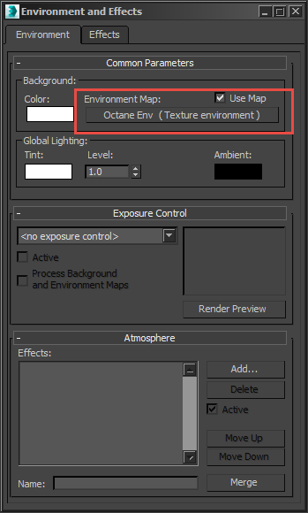

DonFarese wrote:... just trying to figure out how this would be done in 3dsmax plugin? little confusing.
3ds Max application does not imply having more than one environment map. And the plugin was developed from its very beginning to be using the standard 3ds Max environment settings. So, now I need to find a way to rework the current structure to have the second environment somewhere (without breaking the existing scenes compatibility, which already use the "singleton" environment in standard 3ds Max settings)...
I will add the "visible environment" feature in ongoing releases.

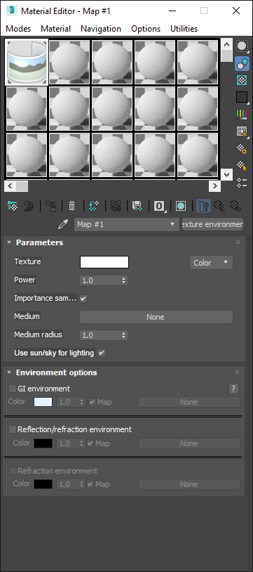

Thanks for looking into this Jimstar. This would be a really good feature to have. It would be great if the texture environment node had a on/off options for light, reflections, refraction. and maybe even a second place in the node for back plates or another HDRI with same options. A must would be to have a checkbox that says "use Octane sun/ Sky to light" so this way you can use sun/sky like I want to but use HDRI only for Back plate, reflections, and refractions. What do you think?

Here is a simple mock-up that I think would be awesome!

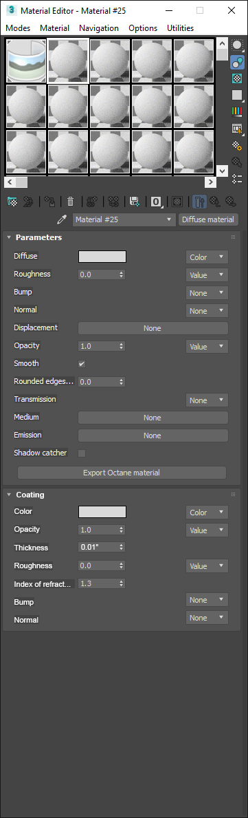

Okay sorry, didn't know.... I'm in no way a programmer. I just made another adjustment to another material, the diffuse material. This would make life a hundred times easier especially for vegetation. I'll post this below but should I post these in the standalone area, it's confusing because it's for 3dsmax but it needs to be made for standalone?.... I don't know.....
