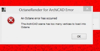

How much did you tried rendering Triangle Polygon to 12GB memory?
Polygon rendering with using no texture.
I Lightwave Plugin users.
40 million error has occurred in the Triangle Polygons to obtain from other users.
When using the Triangle Polygons 39 million were rendered this possible, this case was not only uses 6GB of memory.
But my problem is that the statement of the problem, yet no feedback to the program
I need the help of the user.

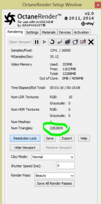

Hi jang2235,
You mean a high triangle number like this?
greetz,
4090+3089ti & Quad 1080ti
http://www.tapperworks.com

rappet
Posts: 1962
Joined: Fri Apr 06, 2012 3:57 pm
Location: The Netherlands
Took more then a few minutes to load, but I got this:
juanjgon
Posts: 8867
Location: Spain
rappet wrote:Took more then a few minutes to load, but I got this:
Are you working with Octane 3, right? ... if this is the case, it is clear the there is a limitation in the number of polygons that can be loaded (around 39 millions), even with a lot of free vram available.
-Juanjo

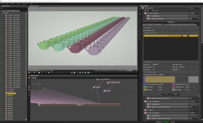

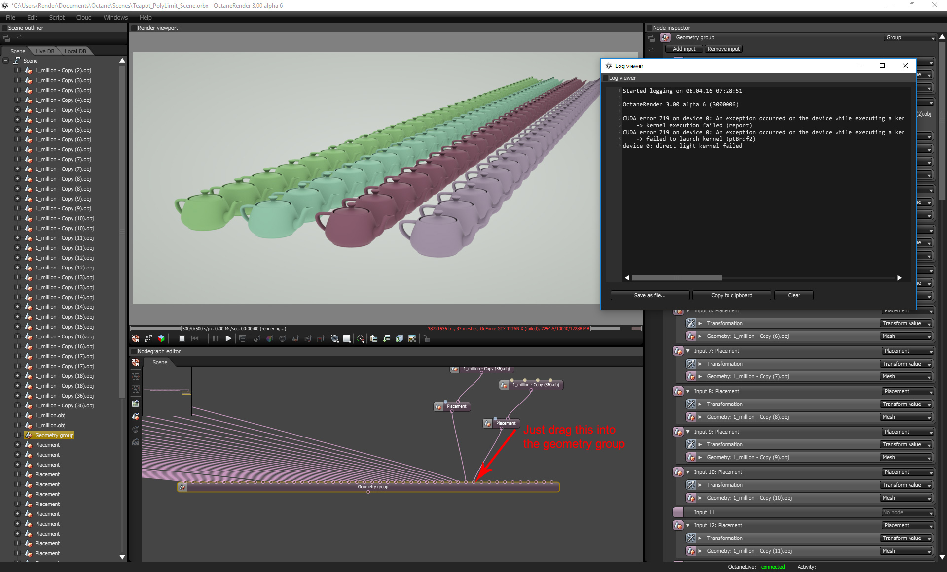

I have the same problem in Octane Standalone 3 alpha 7.
When I was trying to see if I could fit a CAD model of around 55 million polygons on a TitanX at work, I noticed that around 40 million polygons it would just give up. ( I have memory to spare as you can see on the screenshots attached below )
So I created this testscene where the problem occurs:
As you can see on the first screenshot everything is working and I have some memory left:
Working
Working
And when I drag the last teapot copy into the geometry group, it fails:
Not Working
Not Working
Here is the link to the testscene: ( around 700 mb as zipfile, but closer to 4 GB when unpacked )
https://onedrive.live.com/?authkey=%21A ... 9F36BB9FA4
These test are done on windows 10 with driver version 364.72
I really hope that developers look in to this, some of us need to work with large datasets and its not possible to remodel or retopo everything.
