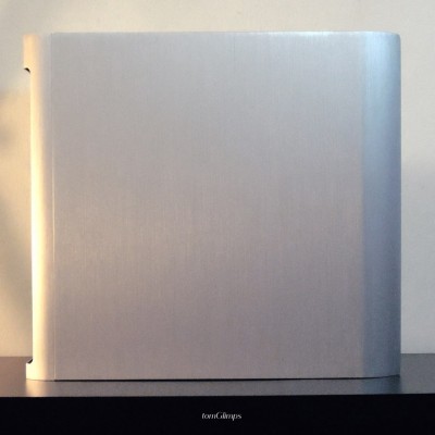

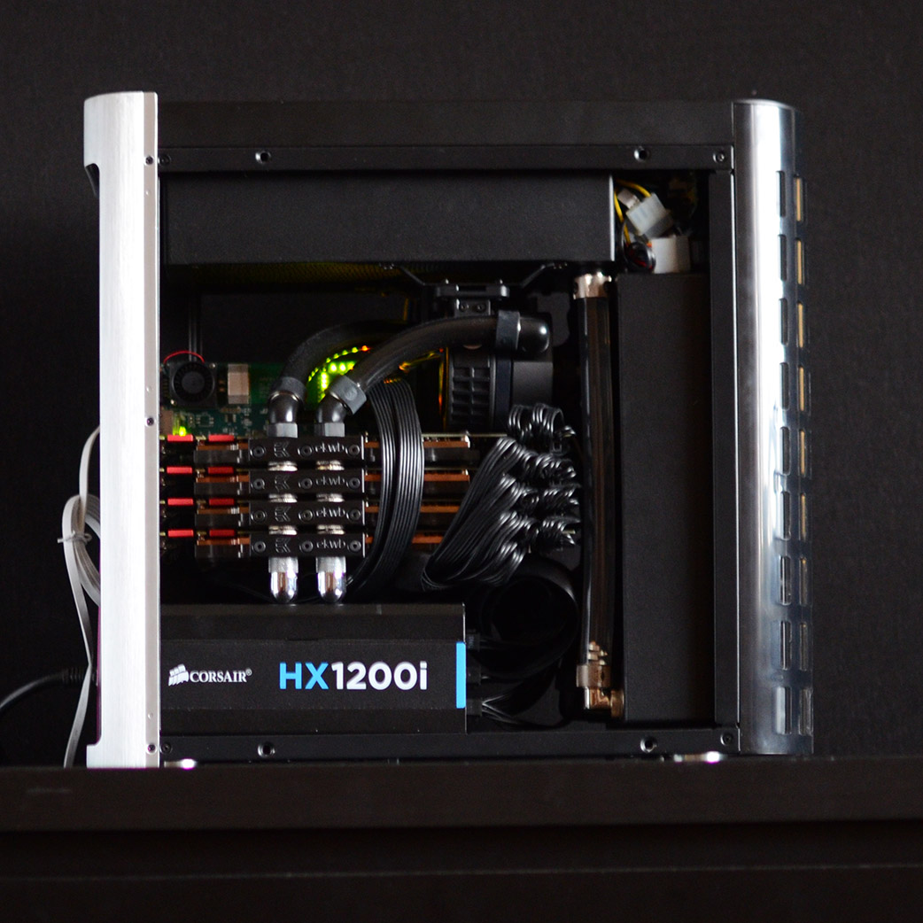

Alternativelly You can build/order eGPU solution, plugged via PCIe to Your box.. - Latelly I've built one box for user who wanted 4 more cards on His Mac 5.1: Check those images & please let me know if You need any more info on that.

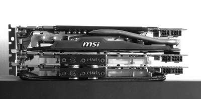

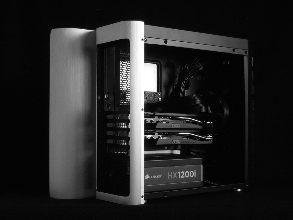

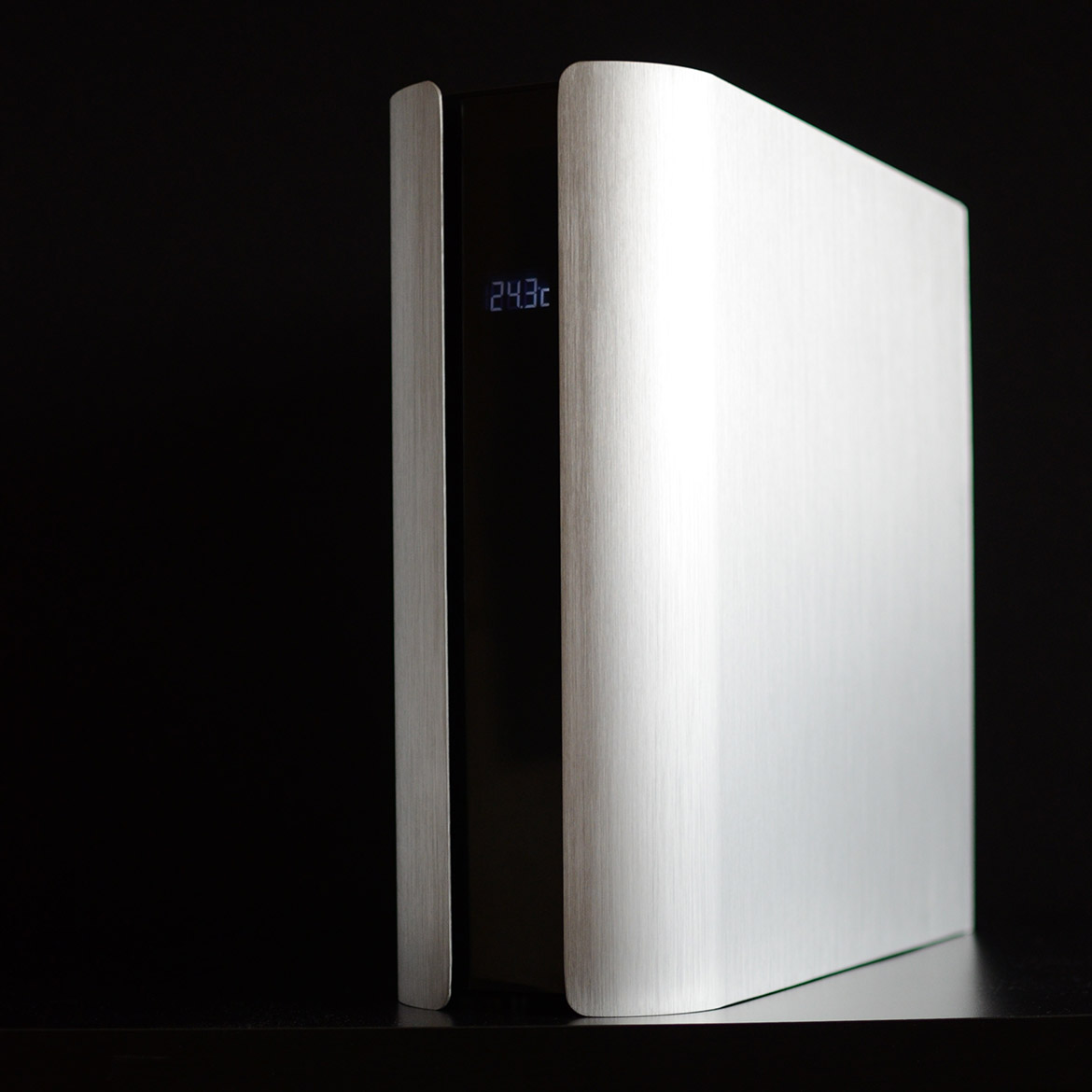

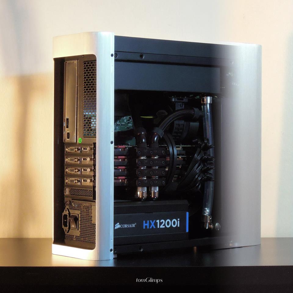

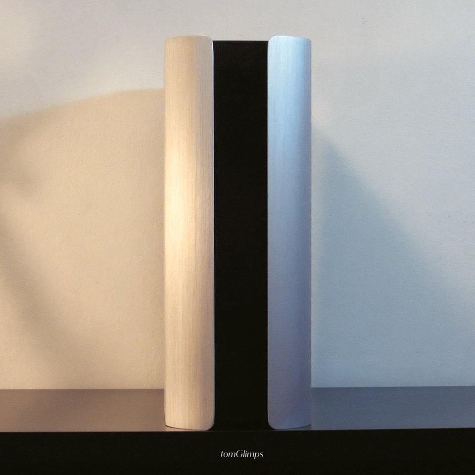

few shot to explain:
originally You can put only two GPUs into this (as most of GPUs are dual slot width & reference coolers are recomended - what You see here is non ref cooler equiped 780 6GB cards, but those were meant to be modified).
Modification is pretty simple: removing one of GPUs connectors, adding waterblcok - this allwos to shrink card to single slot units, here is a comparison from side to understand things better:
once that Single Slot mod done, the rest of watercooling is placed & tubes are routed the build comes to life (weighting ~17KG dry pluss a litre of distiled water should be filled inside before runing it).
once You put side panels, it's very bussines like. Fan speed is fixed so no variatoin in noise output & the only thing You're going to notice is that water temperature screen digits changing.
It plugs to any Mac or PC that would have extra slot for PCIe gen2 1x slot card & comunicates via two cables 3meters of cable is available, so You can place freely around.
Once You power up Your Mac this turns on too & You see GPUs as if they were seated inside =)

should do some calculations, but with 4x TitanXs close to 8kEU including shipping to Italy.
(GPUs alone are like nearly 5kEU, shipping few hundred EU.. then the rest: backplane, waterblocks, rads, pumps, fitings, tube, fans, case - all the best parts You could find & all nesecary modifications to be able to fit - case, GPUs & rads need to be modified..clearances are down to milimeters.. =)
