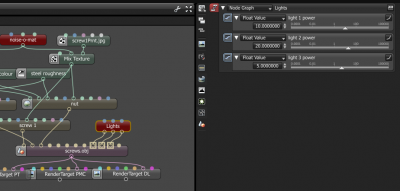

So the new node system is internally a full rewrite. On the outside it looks similar to the old one, but it's implementation is very different. Here a few visible improvements:

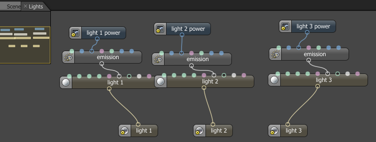

You can now create a node graph and hide some complex node set up. As in the old system, the interface to the "outside world" is done via input / output linker nodes, but now you can create multiple output linkers and input / output linkers can have now every pin type. Here for example, the node graph "Lights" contains three emitters and has three input linkers to control their power:
... all the rest is nicely tucked away inside:
In the node graph editor you can now select a group of nodes/node graphs and group them into a node graph with one click. You can then un-group that node graph with another click. Node graphs can be nested and copied. All macro nodes will be converted to generic node graphs. You may ask why all the effort? There were two main reasons:

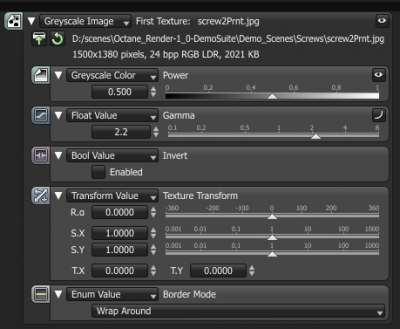

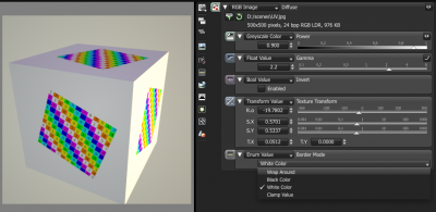

Image Texture Transforms
The scale float pin was replaced by a texture transform pin and a border mode was added:
I guess the options are self-explaining. Btw, the pin replacement and the required conversion of old scene files was what originally triggered the node system re-factoring.

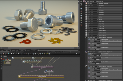

Object Properties
You can now set some visibility properties for objects:
Here I have made the "spiky" washers to the left invisible to the camera. You see only its indirect effects, like shadows and caustics. You can also make it cast no direct shadows and you can set it's overall opacity, which can be useful for fade-in and fade-out effects.
What is an object, since mesh nodes store only a triangle soup? Each triangle can have an ID (number) assigned to, which can come from a plugin or from an OBJ file, which can objects/groups, too. You don't see the object IDs of a mesh node directly, but by connecting it with an object layer map node you can then assign an object layer node to the objects which you want to control.
Time Slider
In the image above you can also see the time slider. It's all still prototype-y, since we just started working on animation stuff a few days ago. We already had some stubs in the new node system, but now the actual work started and I expect it to progress fairly quickly. You can already scrub through the camera animation of an Alembic file. For 1.5 we aim to support loading animated geometry and camera data from Alembic files (with camera motion blur, without object/geometry motion blur). We don't plan to add animation editing capabilities to Octane in the near future, since this is a big task and we think we need to focus on the rendering features.

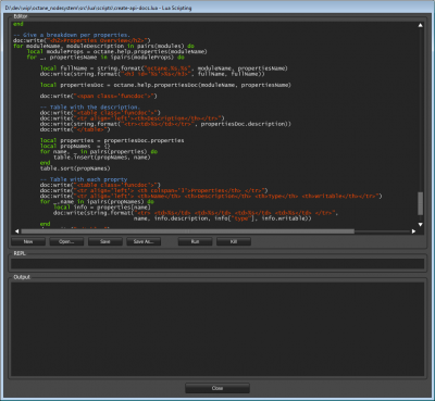

Lua Scripting
The next release will have scripting support with Lua:
It's based on the API and thus allows us to write test scripts and test the API. It also will allow us and users to add some functionality to Octane Standalone without touching the actual code base. It's pretty much work in progress (and will be for a while) and we plan to extend the scripting interface as we go along.

Thanks Marcus, all of this sounds wonderful. :) Will you be able to use Lua for procedural textures?

You won't be able to create a procedural texture directly from Lua (at least not initially). You can generate procedural images from Lua and attach these to your materials as image textures.

Thanks Thomas,
So initially Lua will be used as a pre/post processor before/after the render? Does Lua have access to the object data? It would be fun to see if you could do simple displacement with it.
You can do a bit more than just use it as a pre/post processor. You can control rendering from Lua however it's not possible to for example write your own shaders that are used in the render kernels. You can access all the data available in the nodes (if that's what you mean by object data). Basically, you get the same capabilities from Octane as the 3d party plugins.
Manipulation of geometry (and creating your own geometry) is possible from Lua. So you could apply a displacement map to that geometry (before it's rendered, not while rendering) but rolling your own displacement mapping from Lua sounds like a daunting task :)
The idea is that users can use it to create their own tools on top of Octane that are not generic enough to warrant an implementation in Octane itself.
