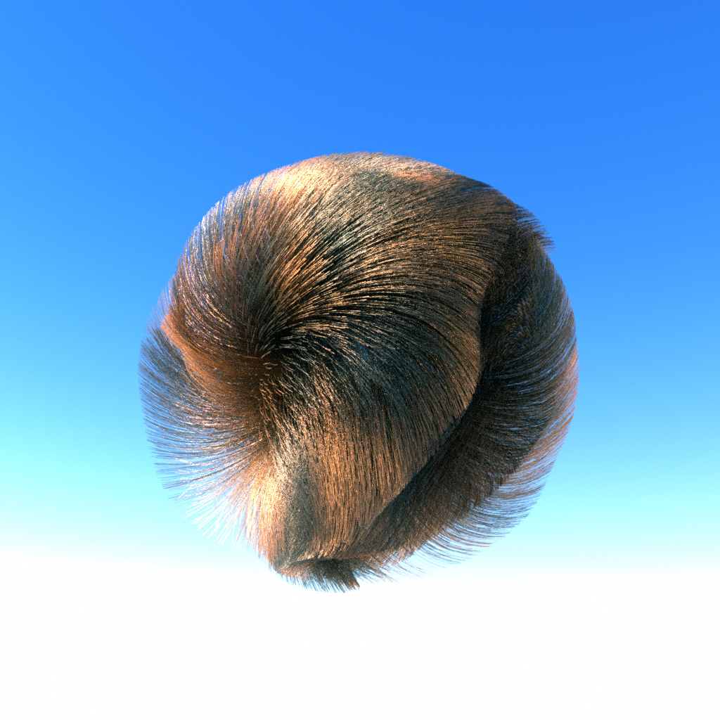

This is what i have made in the Softimage exporter.
But fibers need a lot of vram when the result should looking good.
The image below has 7.5mio triangles which need around 1GB vram.
