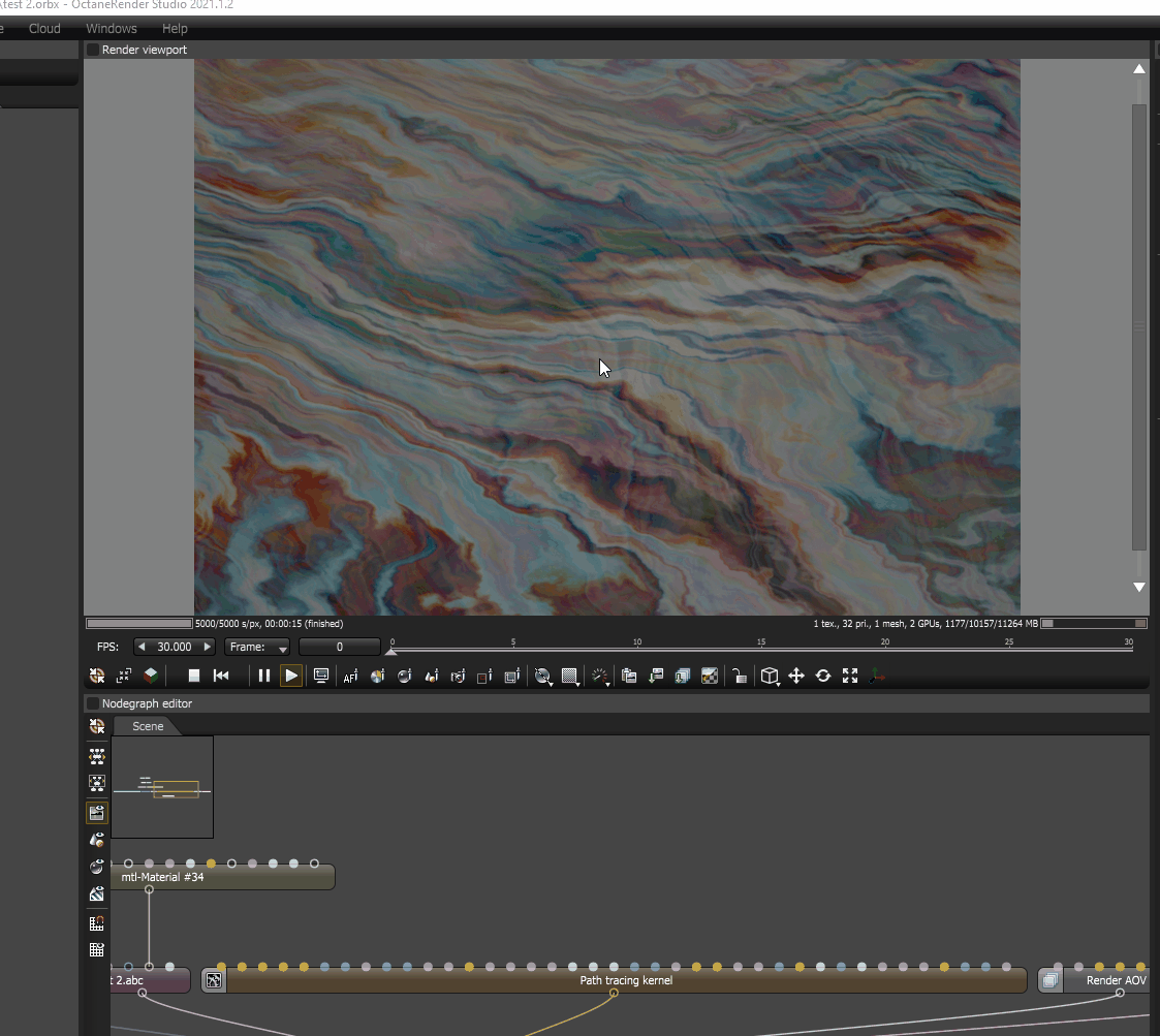

Faced with an issue: Some lags during rendering. And it's looks like two textures overlapping.

I'm not seeing these artifacts in standalone 2021.1. Maybe it's version or plug-in specific?

jobigoud wrote:I'm not seeing these artifacts in standalone 2021.1. Maybe it's version or plug-in specific?
3ds Max 2022 OctaneRender 2021.1.3 - 12.14
Standalone - same lags:

Here is my test scene. Does it work for you?
Could you share a simplified version of your scene showing the problem?
