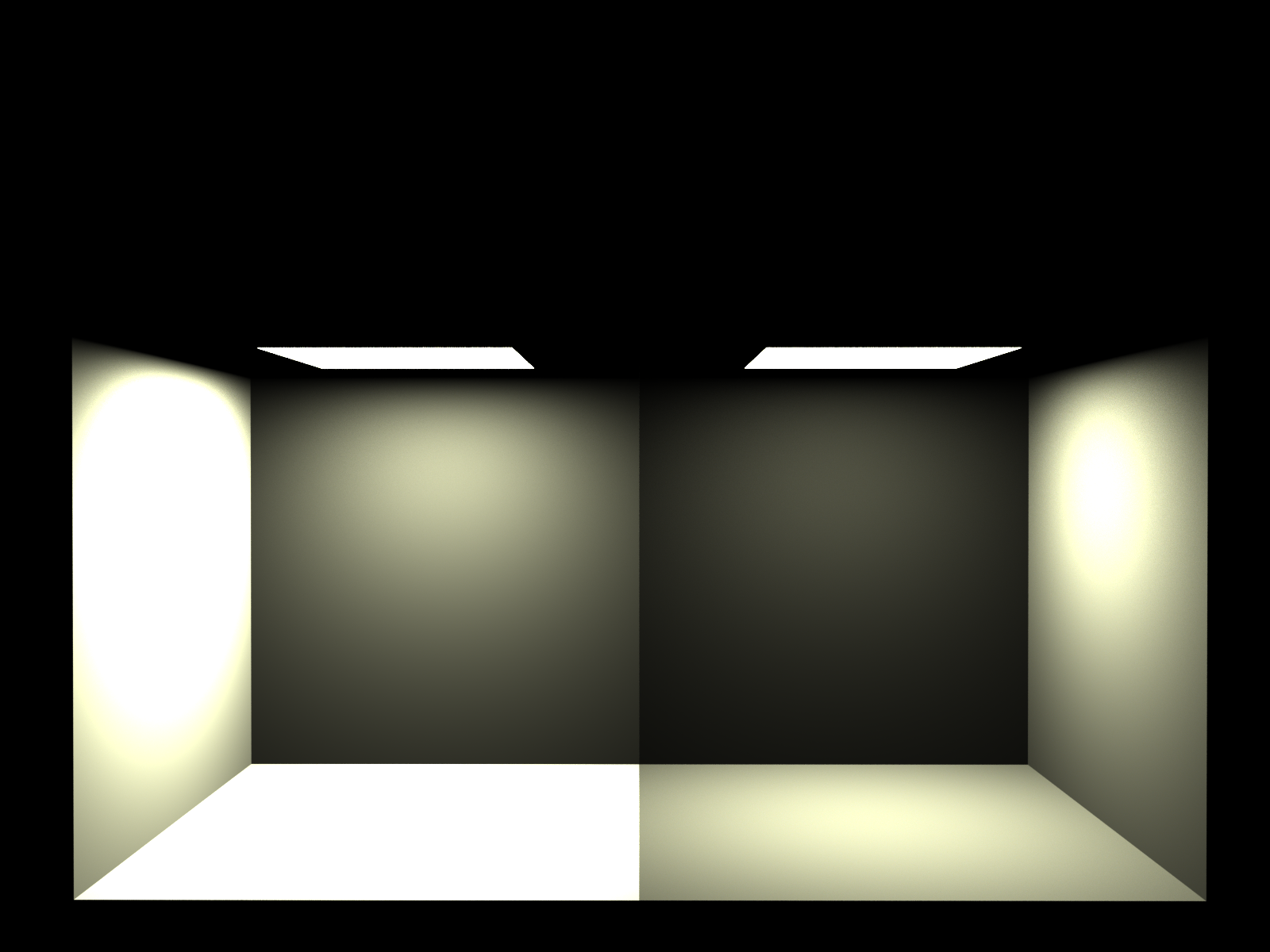

- How are emitters with 'surface brightness' scaled with respect to their area? I have below an example scene where two emitters in separate boxes each have identical emitter materials, except that the one on the right is 'surface brightness'. The emitters are both 1 square metre, have not been scaled in the placement node, the camera has a linear response and no gamma applied. Assuming that 'surface brightness' means watts per square metre, these should be the same brightness, but clearly they're not. In fact, the one on the right needs to be 2.2 times brighter to look the same.
Comparison of two 1m x 1m plane emitters. One on the right is surface brightness, otherwise identical to the one of the left.

Surface brightness scales by area but there's also an additional scale factor of 7/π (~2.228). This seems to be left over from very early versions of Octane.
