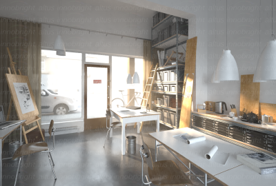

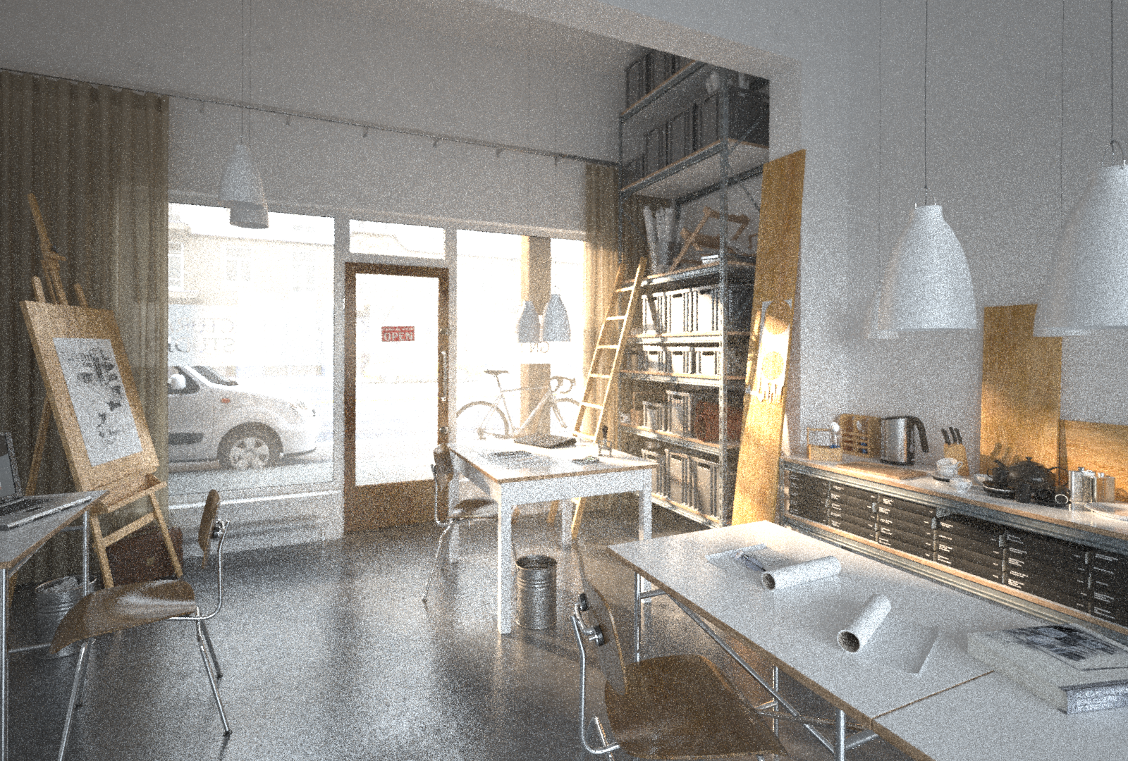

From the Chaosgroup forum. 8min rendering, 2min denoise:
Images from vlado
Altus rendering denoising system
