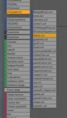

I really like that you have provided easy access to community OSL scripts in your node editor. It is really handy.
Please can you update the quick access pre-set in the Octane Node Editor to this more advanced version of OSL flakes?

I've just been pasting the updated OSL shader code into the OSL node to overwrite the old osl flakes code that comes with the plugin.
I didn't know it was an option to edit these node editor pre-sets. How do I do that?
Regardless, wouldn't you rather include the best version of this OSL script? It's objectively better, it doesn't change any of the core features other than append the ability for it talk to octane projections.
