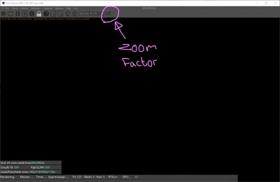

I just noticed that there is already a primitive implementation of a zoom canvas function already implemented.
This is really useful and is good enough for my needs so maybe there is no need for that feature...
A LV resolution scaler for IPR/scene setup would be great though :)

Did we lose the zoom factor dropdown? Not seeing it in 2020.1.3-R2. Thanks all.

2020.1.5 - Thanks for adding this zoom feature in full.
Works perfectly. Thanks Ahmet excellent work :D
