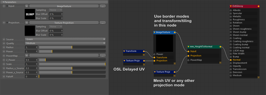

Here is how the UI should look like by default with all of the default values and an example node graph setup.

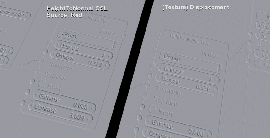

I’ve been working on this one for a while as I was learning more and more about normal maps in Octane. It went through a lot of changes and adjustments. I use it on a daily basis and whenever I would be annoyed by something or wish that some parameter had a different min/max value, I would change that. It solves a few limitations of the builtin bump map input and it gives you total control.
Description
This node converts a bump/height map into a tangent space normal map based on average, luminance or the intensity of each RGB channel.

Connect an image texture node with your bump map to the Input pin. Give it OSL delayed UV projection. Adjust Radius and Power to control intensity of the map, and that's it! If you find that you need to use too high or too small values, adjust Scale. Default values for quality and source should work just fine most of the time.
Parameters
- Input
Connect your ImageTexture node with a bump/height map here.
IMPORTANT: For your ImageTexture node to work, you need to connect a Texture Projection node with ‘OSL delayed UV’ projection. Don’t worry, you can still add your own projection in the Projection input of the OSL shader. :)
- Projection
You can add your Texture Projection node here. By default this input should return Mesh UV but currently, in C4D, without anything connected, projection will be box for some reason so make sure you add a Texture Projection node here.
- Source
Here you can choose how the height information is extracted from your texture. Default value is Green because that channel is the least affected by compression artifacts. If you want to mach how your displacement map looks you can choose the Red channel here.

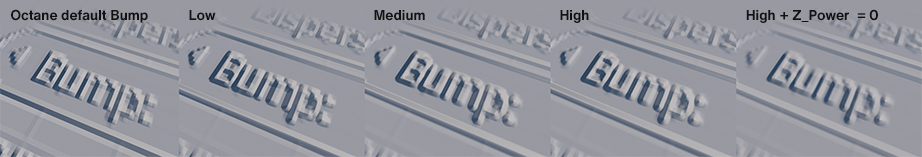

- Quality
Here you can choose the method that does the sampling and conversion. These methods are based on standard convolution filters.
Low quality method is using 3 samples. Cheap + fast. Works great on procedural maps.
Medium - 4 samples – This the default. Almost as good as high with only 4 samples.
High (slow) - 8 samples. This is using a sobol algorithm. Great results but 2x more samples than medium.
What this means is that any node graph connected on Input will be evaluated 3,4 or 8 times in order to create a color of one sample that this shader is returning as a result. If you have a very complex network of procedural nodes or too many layered textures connected on input you will quickly realize what I meant by “(slow)” (and why SD is such a popular tool). In most cases, if you are just converting a bump map into normal map, you will not notice any performance issues but in some extreme cases you might want to use a baking texture after this shader

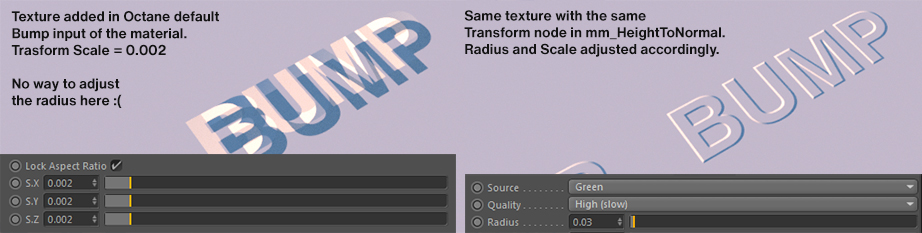

- Radius
Radius of the area that is sampled. You can think of this as blur. But for bump/normal maps, blur also means “more intense”. Also this is one parameter that we don’t have in the Octane default bump input. If you take a big texture and use transform node to scale it down too much you might run into the issue that you see below. In this OSL shader you can easily avoid that by adjusting Radius to a smaller value.

- Scale
This value is scaling the sensitivity of Radius and Power. Since those parameters will change a lot depending on the resolution or tiling scale of your map, I added this option to avoid dealing with too small or too big values with a lot of zeroes and having to type them in.

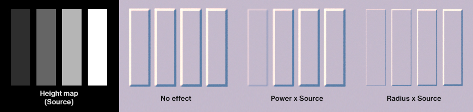

- Radius_x_Source and Power_x_Source
These parameters allow you to use height information from your map to scale Radius or Power. Depending on the level of sharpness of the features in your map, sometimes you might want to increase one or the other.
