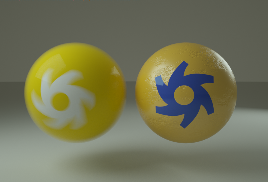

I need to make an emoji/smiley. I create a yellow glossy material. On the same sphere i have to layer/place the eyes and mouth which is a PNG or TIFF with transparency.
I got it to work in C4D only but in no way i can find out to do this in Octane. Am i missing some sort of 'Alpha" check box which C4D uses? Do i need to render out a separate black/white picture as a matte?

check this

Many thanks Ahmet,
Although you used a black/white png i think i can track back the procedure of applying a png/tif file in full color.
